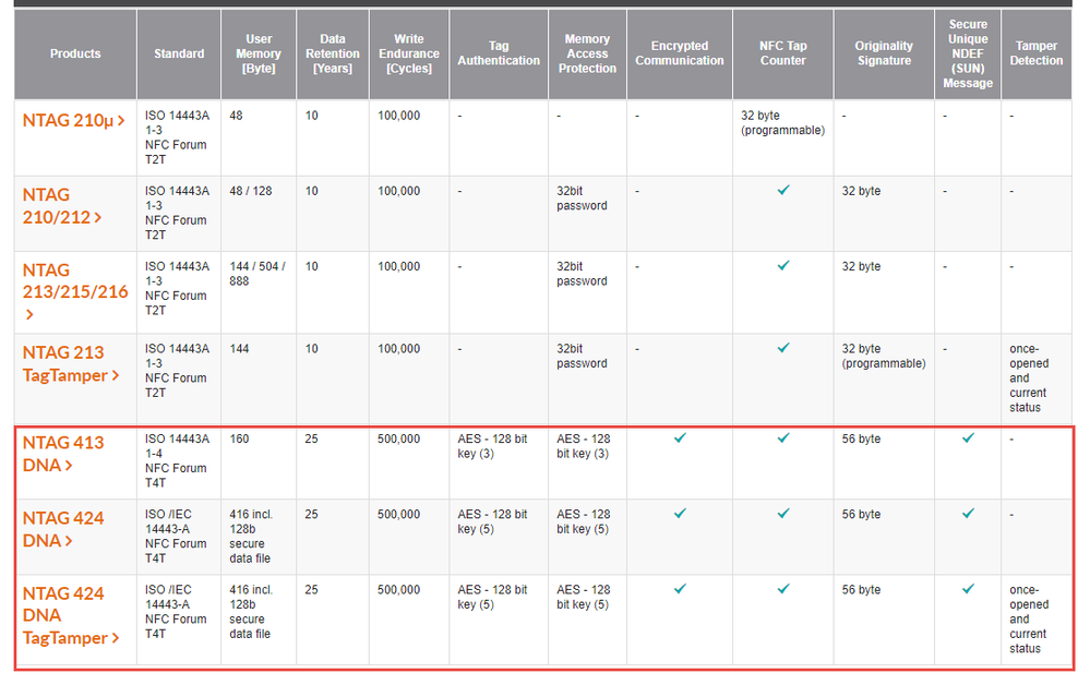

Hi !
Where I can find the SUN algorithm (AES encryption) used by the NTAG 215 DNA to sign the UID+usage counter ?
Thanks, Stefano
2,057 Views
Jonathan_Iglesias
Dear Stefano Della Valle,
Hope you are doing great, the NTAG 215 is not part of the DNA family the NTAG DNA are the 413, 424 and 424 TT.I am not aware of the 215 being a DNA and supporting SUN and AES features, if you meant the 413 or 424, the documentation is available in Docstore, you should sign an NDA (Non Disclosure Agreement), if you do not have NDA create an internal ticket Support|NXP  so you get help to sign an NDA and then get access to the documentation. please check the examples in Features and Hints for 413.
Jonathan
2,057 Views
stefano_dellava
Great thanks! Yes, I wrote the wrong NTAG name. I need to work with the NTAG 413 DNA.
I'll contact the support.
