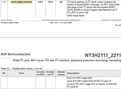

1. The range of LAST_NDEF_BLOCK is from 1h to 37h, and the corresponding NFC page range is from 4h to DCh. Based on the given information, the calculated byte size is D9 * 4. This means that from the starting page to the last page corresponding to LAST_NDEF_BLOCK, the entire data area contains D9 NFC pages (each NFC page is 4 bytes)
2. According to NFC Forum Type 2 Tag specification, the value of byte 2 of the CC multiplied by 8 equals the data area byte size. the data area byte size as D9 * 4
(D9 * 4) / 8 = 217 / 2 = 108.5. As byte 2 of the CC is an 8 - bit data (1 byte), its value should be an integer.  it becomes 108 in decimal, and converting it to hexadecimal gives 6C.
So, according to the specification, the CC should be set to  :Byte0:0xe1 , Byte1:0x10  Byte2:0x6c Byte3:0x00  right?

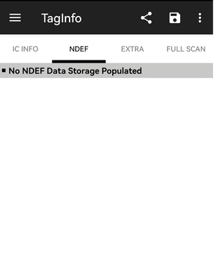

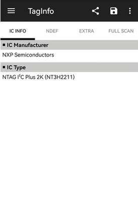

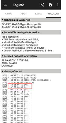

1,581件の閲覧回数
Tzf
after set CC and LAST_NDEF_BLOCK
the session bytes FEh:
0~7 byte value: 0, 0x37, 0xf8, 0x48, 0x8, 0x1, 0x0, 0x0
the i2c block0 0~15 value:
0x4, 0xa9, 0x35, 0x12, 0xf0, 0x71, 0x80, 0x0, 0x44, 0x0, 0x0, 0x0, 0xe1, 0x10, 0x6c, 0x0
Not clear why the TagInfo cannot detect NDEF information
