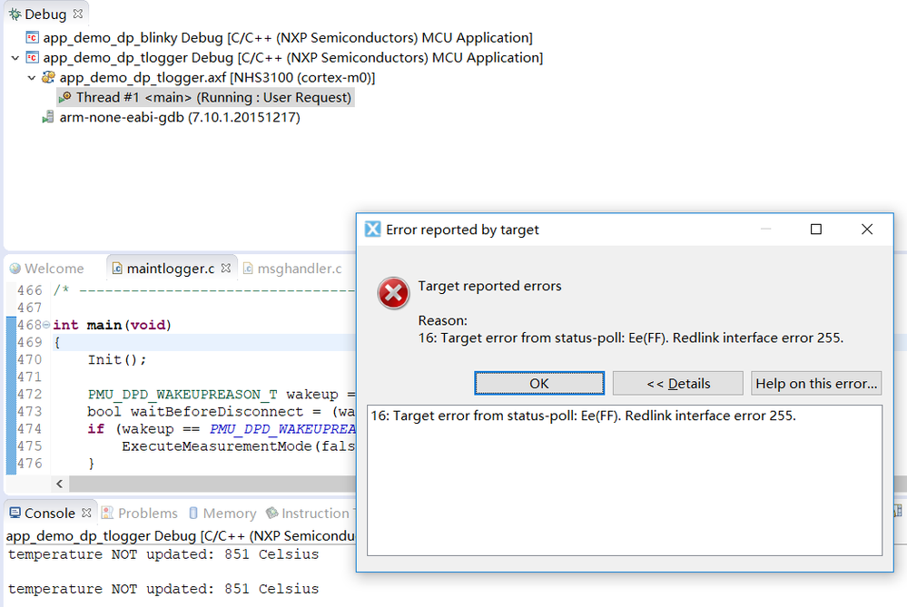

Hi Sirs,
Anyone knows why "Redlink interface error 255" reported and how to resolve it?
As follow screenshot:

Had same message and screen w/ LPC1769 OM13085 - but only in release version, not in debug version of same code. Also, not with OM13000 board.
I tweeked Release in Debug Configurations / Debugger (Set VECTRESET, det support for semihosting) and it runs again

The most likely cause is that the firmware went to Power-off or to Deep Power Down. In these two power modes, the Debug HW block is not powered and access via SWD is not possible.
Use the define APP_MAINTAIN_SWD_CONNECTION in maintlogger.c and rebuild. This will avoid these two power modes, at the expense of a much higher current consumption.
