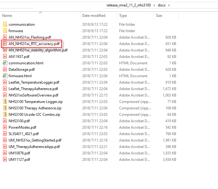

Hi Fantasy,
If you download the NHS3100 SDK(https://www.nxp.com/webapp/Download?colCode=RELEASE-MRA2-NHS3100-11_2&appType=license&Parent_nodeId=... ), you may find the app note on this topic in that package. Please refer to the following for more details.
Hope that helps,
Kan
