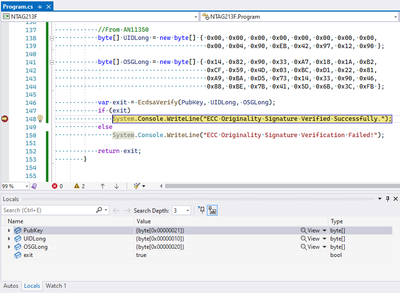

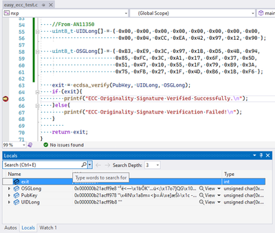

Firstly, please note that I have confirmed my signature verification should be correct as per the following post: Demo for Originality Signature Verification - NXP Community. This was checked by executing the example ECDSA verification algorithm against other known NTAG213 UIDs and signatures, e.g.:

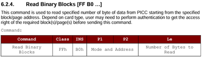

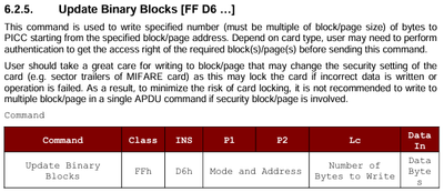

For my specific setup, I'm using an ACS ACR1552U NFC USB reader which works nicely for reading/writing from/to the manufacturing data, user memory data, and the dynamic lock bytes. I used the following ACR1552U commands for general read/write, respectively:

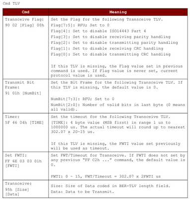

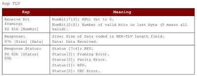

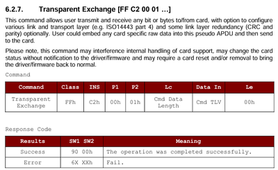

As for reading the originality signature, this was slightly more complicated. I had to use the Transparent Exchange command to passthrough the READ_SIG command to the NTAG213, as shown below.
Transparent Exchange command (ACR1552U):

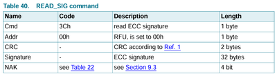

READ_SIG command (NTAG213):

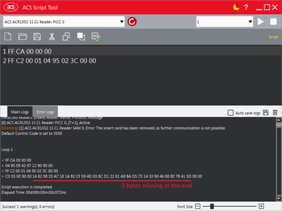

First thing I tried was to remove my software from the equation and I did so by using the NFC reader manufacturer's own tool which supports command scripting. The specific tool I used was the "ACS Script Tool 5" running in a Windows 11 environment.
The specific command I used was: FF C2 00 01 04 95 02 3C 00 00. This corresponds to the Transparent Exchange command in transceive mode. And the NXP NTAG213 command being transceived is 3C 00, which corresponds to the READ_SIG custom command.
Below is a screenshot of the observed result after running the command:
To highlight the issue, I have underlined the signature payload bytes. The other bytes in the response indicates that the command was executed successfully (according to the following List of APDU Responses), e.g.:

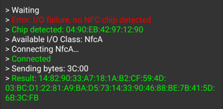

The second thing I did was to remove the ACR1552U USB NFC reader from the equation. Unfortunately, I did not have access to any other NFC readers other than a smart phone. Nevertheless, it was really just to confirm that the NTAG213 NFC tag itself is behaving correctly. Indeed it does as shown in the next screenshot:

P.S. For completeness, here is the signature verification result (C# implementation):
