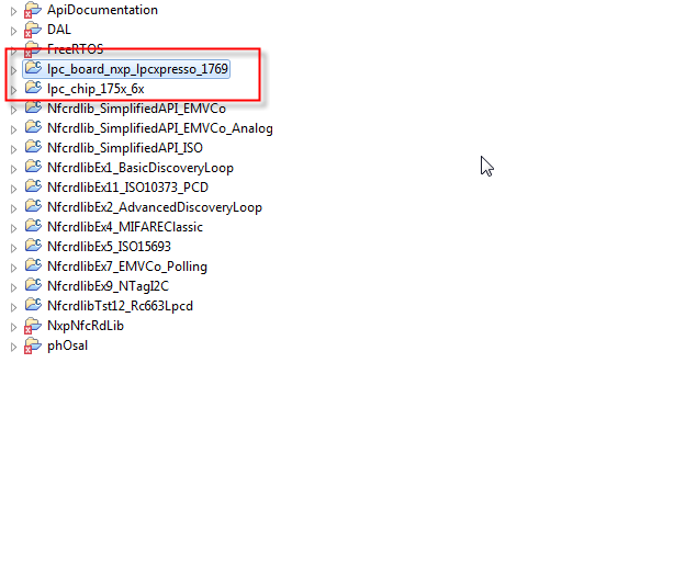

So far the NFC reader library supports LPC and Kinetis, not including STM32, so if you want to use STM32, you have to do the porting, mainly the LPCOpen lib.
Kan
