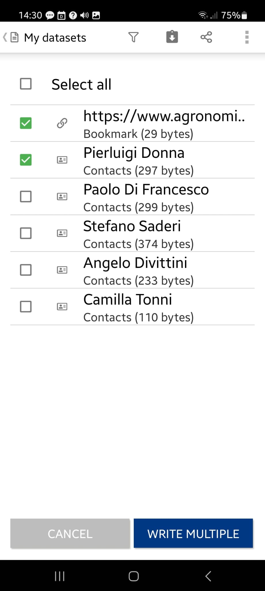

I create a multiple lines nfc tag using the "add more" option and adding a business card + web address.
But I'm not able to create the same tag using the data stored in "My dataset" because using "write multiple" option it doesn't create a multiple lines tag.
And if I use "add more", it's not possible to choose from "my datasets".
Thank you

I use NXP TagWriter on Android phone. I already create a multiple tag, to write it on an NFC tag, that includes both Vcard and internet address, using the "add more" option to create the second line. When I click on "add more" I can just add a new dataset (writing or importing it), but I cannot use a dataset previously stored in "My dataset". This means that I can use "my dataset" just to prepare the first part of the data group (link or Vcard), and not to add the second part.

I have multiple set of data in "my dataset" (ScreenShot .......0013) , but when I click on WRITE MULTIPLE and select 2 sets (SS 14), then the content that appear is just one of them (SS ....4950).
And if I click on ADD MORE, it appears the list of NEW DATASETS, in this screen I cannot choose MY DATASET (SS 15).
If I choose MY DATASETs>MORE OPTIONS>WRITE MULTIPLE>ADD MORE>[not from MY DATASETS, but from the list of new datasets that appear]eg:LINK..., in this case aI can create a multiple-line tag (see screenshots n° .....16)
Thank You

Please go to the below link and update Tagwriter, after that your issue will be fixed.
