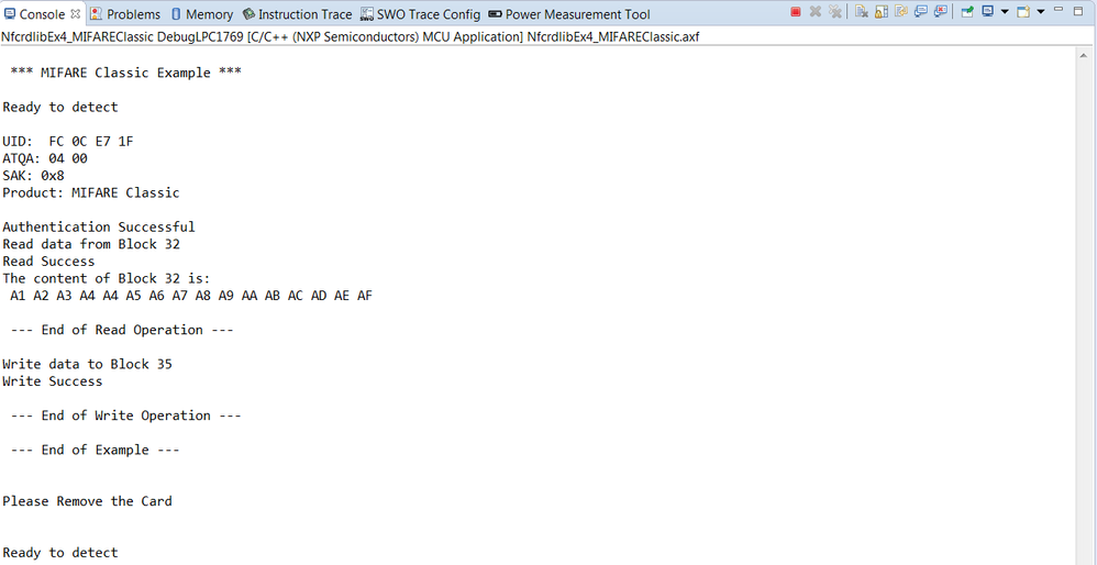

Hi all,
I have PNEV5180 board and Mifare Plus card in SL1  Mifare Classic emulation mode.
I try to work with sector number 8 and known keys.
This Android application works with this card without problem https://github.com/gshevtsov/TroikaDumper
I tried sample NfcrdlibEx4_MIFAREClassic from NFC Reader Library package.
In result:
UID:  04 4D 3C 92 61 36 80
ATQA: 44 00
SAK: 0x8
Product: MIFARE Classic
Authentication Failed!!! Please correct the used key
I change only the NUMBER_OF_KEYENTRIES, Key and sector number in example.
What is wrong? Should I make anything else?

Hello T L,
In order to work with sector 8 it is needed to authenticate in one of the blocks within sector 8.
Mifare's sectors structure
Mifare classic 1K: EEPROM memory is organized in 16 sectors of 4 blocks.
Mifare classic 4K: EEPROM memory is organized in 32 sectors of 4 blocks and 8 sectors of 16 blocks.
Sector 8 corresponds to Block 32 (Sector 8 * 4 blocks = Block 32). The authentication must be made within this sector, starting from block 32 to block 35.
Code section:
#define NUMBER_OF_KEYENTRIES        2
#define NUMBER_OF_KEYVERSIONPAIRS   2
#define NUMBER_OF_KUCENTRIES        1
/* Set the key for the MIFARE (R) Classic cards. */
uint8_t Key[6] = {0xFFU, 0xFFU, 0xFFU, 0xFFU, 0xFFU, 0xFFU};
/* Don't change the following line */
uint8_t Original_Key[6] = {0xFFU, 0xFFU, 0xFFU, 0xFFU, 0xFFU, 0xFFU};
/* Send authentication for block 32 (sector 8) */
status = phalMfc_Authenticate(&salMFC, 32, PHHAL_HW_MFC_KEYA, 1, 0, bUid, bUidSize);
Once you’ve already authenticated in this sector, you’ll be able to get access to all blocks of sector 8.
Debug section:
Ivan.
