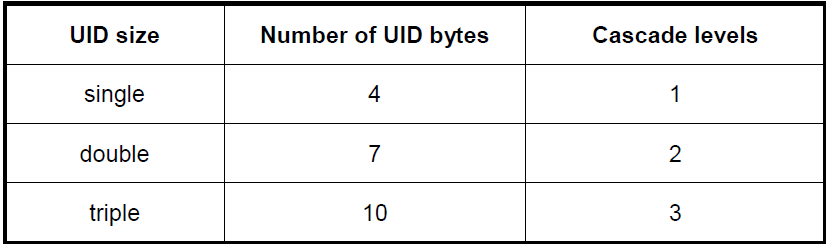

Hi Andrew Villagran,
as you may know the ISO 14443 cards can be found in 3 types of UID
and about the card form factors, it is important to mention that NXP does not sell the full card solution, by this I mean  IC + Antenna + wrapper  we sell the IC inside the card, we have a list of manufacturers  that can help you with this solutions using NXP ICs.
