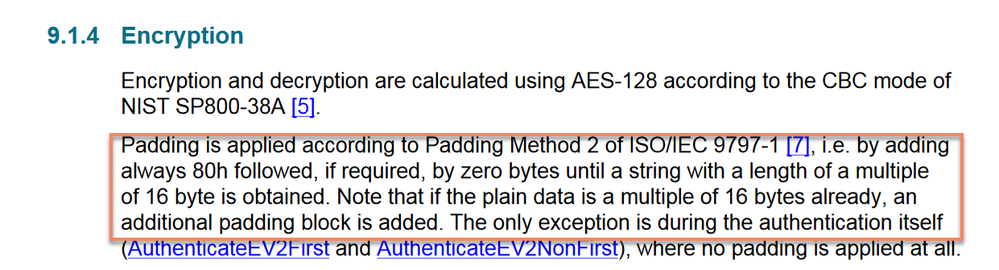

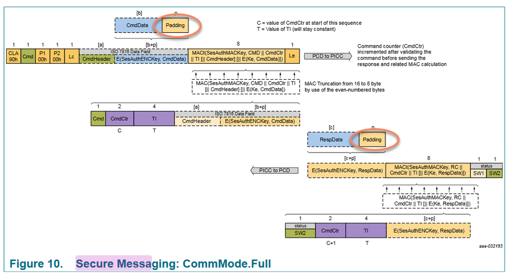

That is because the comm mode is full and data filed includes secure messaging. Please refer to the following for details.
so due to the padding, you can only write 239 bytes in one command, and the same rule applies for the read operation.
