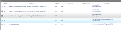

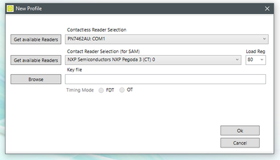

We are very new to the NFC space so we appreciate all the help. We just got the MFEV 730 reader, connected it via USB, downloaded RFID Discover Lite, and created a new profile. For the Contactless Reader Selection, we have PN7462AU: COM1 selected. For the Contact Reader Selection (for SAM) we have NXP: Semiconductors NXP Pegoda 3 (CT) 0 selected.
I then hit Ok and look to the history where I see the following
Status: Fail
StatusInfo: Unable to find an entry point named 'phhalHW-DUT_Init' in DLL "NxpRdLibdll'
Module: RWD
Command: Open
Sent Data: PN7462AU: COM1; NonX=1;
I also see the following:
Status: Fail
StatusInfo: BAL,USE_Condition
Module: SAM
Command: Close
Sent data: NXP Semiconductors NXP Pegoda 3 (CT) 0

Please make sure to configure the MFEV730 in PCSC mode (that's default at delivery) and use "NXP Semiconductors NXP Pegoda 3 (CT) 0" as contact reader, and "NXP Semiconductors NXP Pegoda 3 (CL) 0" as contactless.
Please note: this will only work if a tag is placed in the reader when connecting.

From you screen shoots I can see that the MFEV 730 is in PCSC mode as you can set the NXP Semiconductors NXP Pegoda 3 (CT) 0 for SAM,  but you are trying to use VCOM for CL communication. You should change the VCOM to NXP Pegoda 3 (CL) and the reader will work in PCSC mode. If you change the mode of the reader to VCOM the NXP Pegoda 3 (CT) and (CL) will disappear from device manager and you will get a new VCOM device. This can be then used in RFIDiscover (not you will not have a CT PCSC device any more!)
