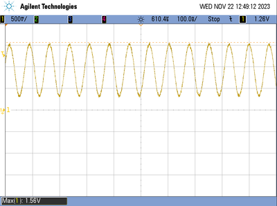

Then the regulation should work properly. See the RX voltage measurement done for the PN7160 Dev. kit.
If not, you have to increase/decrease the RX resistor

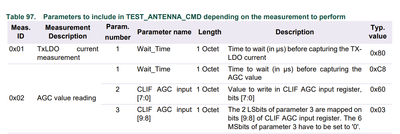

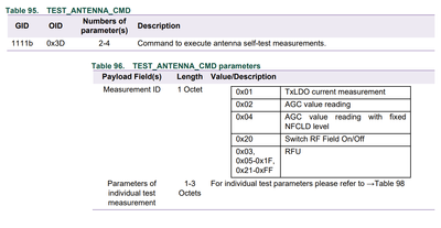

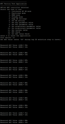

Tomas_Parizek
I typically do it with the help of the Raspberry Pi.
The corresponding command
Here is the code I use:
static void AGC (int handle)
    char get[] = {0x2F, 0x3D, 0x04, 0x02, 0xC8, 0x60, 0x03};
    char Answer[255];
    printf("Get AGC value (enter 'ff' during tag ID selection step to leave):\n");
    while (1)
	printf("\n");
	tml_transceive(handle, get, sizeof(get), Answer, sizeof(Answer));
	if ((Answer[0] != 0x4F) || (Answer[1] != 0x3D) || (Answer[3] != 0x00)) {
	    printf("Error, cannot get parameter value\n");
	else {
            printf("\n");
            printf("Measured AGC Value (LSB)= %.2Xh" , Answer[4]);
	    printf("\n");
	    printf("Measured AGC Value (MSB)= %.2Xh", Answer[5]);
            printf("\n");
This is the output data I get (for PN7160 but for PN7150 it should be the same):
Would this help somehow?
