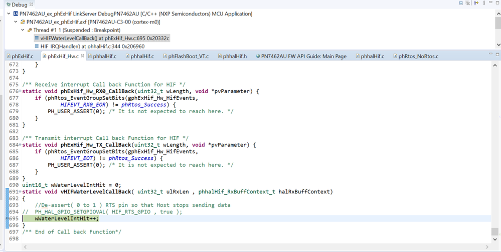

Now the Waterlevel is configured at 240. and Rx buffer size is 248. When Waterlevel interrupt is generated, GPIO_2 in transit from 0->1. Which will make FTDI232 stop sending data. Now when I transfer 320KB of data I am seeing an overflow error in ErrorCallback. after debugging I found that when I get an overflow error GPIO_2 is low means the Waterlevel interrupt has not been Hit. I have verified the same in debug mode by putting a counter. in Rx callback and Waterlevel callback. I am attaching the HIF section for reference.
I am also attaching a debug window from which I have driven this conclusion. As you can see when an overflow error has occurred. the Waterlevel hit count() and Rxcallback hit count() are the same it means more than 248 bytes are received but the Waterlevel callback has not been hit and Error callback is called. What could be the reason behind the Waterlevel interrupt not generating. Let me know if more information is required.

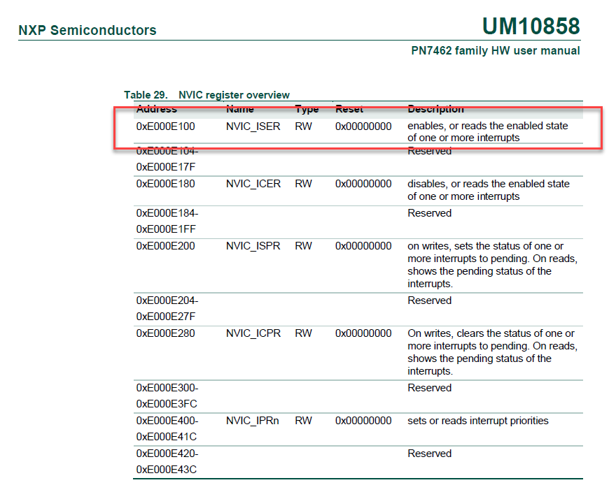

Please kindly check the following register on your side.

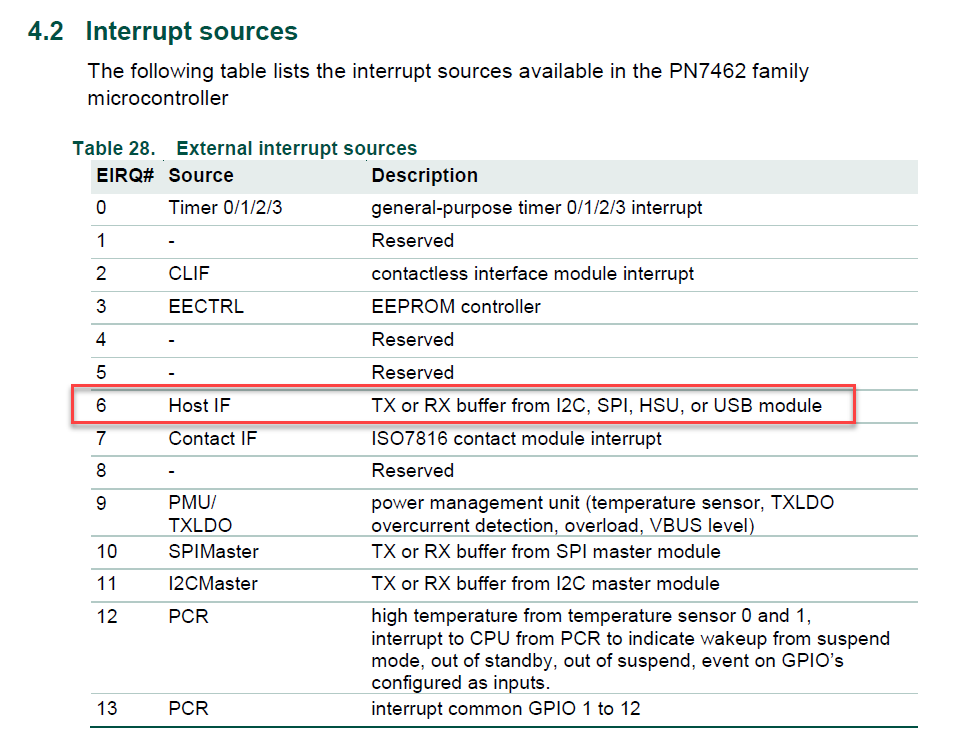

Thanks for the information! I have noticed you enable the waterlevel interrupt of HSUART, but didn't find where you enable the Host IF interrupt of NVIC. Would you please clarify? Please kindly refer to the following for more details.

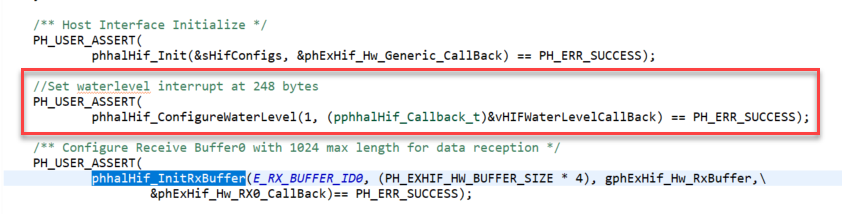

I tried to reproduce your issue here but it works as expected. I built the test code based on phExHif demo, just put phhalHif_ConfigureWaterLevel() right before phhalHif_InitRxBuffer() as described in the API guide.
and the callback was hit right after 1 byte sent out.

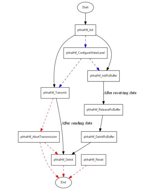

You may refer to the API guide or the following for more details.
