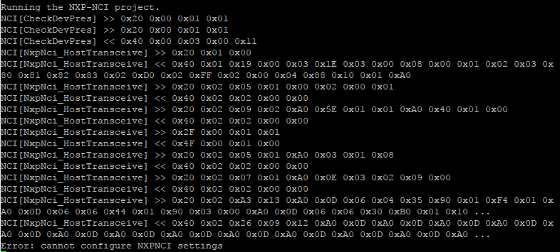

I have ported the NXP-NCI_LPC82X_example to a PSoC mcu, and it is now running on a costum board that includes a PN7150.
While developping the software i ran into an issue with the PN7150.
It worked for about a day and then i suddenly received the message that the NFC settings cannot be configured.
At first i thought the PN7150 was corrupt because i read this discussion:  PN7150 stopped working · Issue #59 · NXPNFCLinux/linux_libnfc-nci · GitHub
So i changed the settings as suggested in that discussion, and replaced the PN7150 with a new one.
After that it worked for a day again, but now its back to the same issue.
I am unable to fully decode the NCI messages.
I have provided the logs below, can anyone see what is going on here?

Hi Wesley,
The last two frames are not complete, so I could not know what they should be, but from others, looks like the third NCI frame has some issue, others are good at core configuration. The third frame should be 6 bytes, but here you just got 40 00 03 00 11, it should be 40 00 03 00 11 00/01 to show if  NCI RF Configuration has been reset successfully.
Hope that helps,
