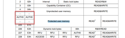

Fabian_R
Hello, Thank you for your interest in our products.
AUTH0 is intended to be used for defining the starting page address of the protected area in Sector 0. Please take a look at the Memory Organization of the NTAG I2C. The starting address for AUTH0 is shown in the following image:
This is from section 8.3.1 Memory map from NFC perspective. Please keep in mind that the value cant exceed 0xE0. 0xFF will result in an error that could lock the NTAG.
Unfortunately, the use of Flutter is out of my scope but, please take a look at RFIDDiscover for configuring the NTAGs using a GUI. The output log of this action will help you for implementing it to your Flutter application.
