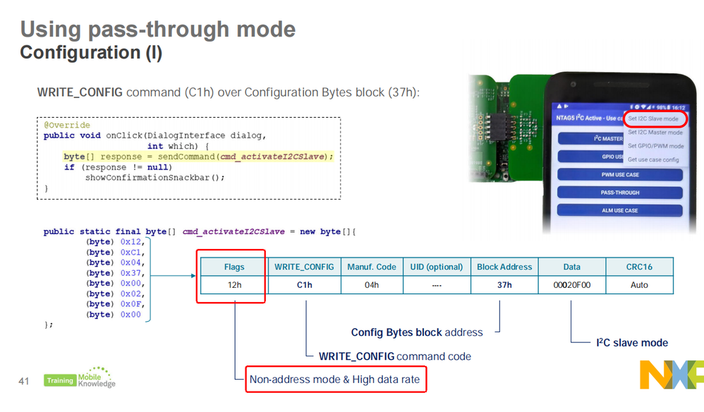

komal18apr
Hi Jimmychan,
I want to implement like figure on page 9 first, then implement like the Figure 2. at page 11 also to complete the pass-through mode.
Thanks for sharing another pdf for example understanding. It helped a lot in understanding many things. And I hope, I am nearer to the solution as well.
I want the explanation of flags byte, which is always the first byte to be sent in any request instruction just like given in that example pdf on page 41, attaching screenshot here, highlighted in red blockipmsgclip_s_1751349909_0.png.
If there is any specific document explaining about those flags in every condition of operation with NFC tag, please share.
