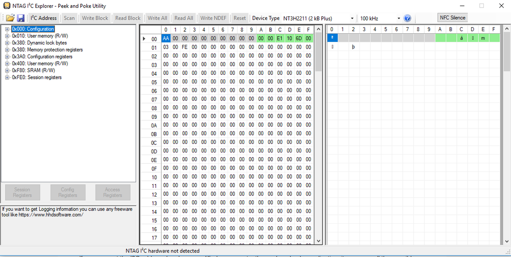

If you suspect the I2C address has been modified, you may try the peek and poke application, it can scan all the possible address and find the right one.
This window app can be downloaded from https://www.nxp.com/downloads/en/apps/SW3652.zip , please also note the MCU connected with Ntag I2C should be programmed with the following firmware:https://www.nxp.com/downloads/en/snippets-boot-code-headers-monitors/SW3647.zip

I am not working with the NXP developer board. The NFC chip I am programming is in our product. I can use the i2cdetect utility to scan the i2c addresses.
When I wrote 0xAA to byte 0 the chip does not appear in the scan anymore.
