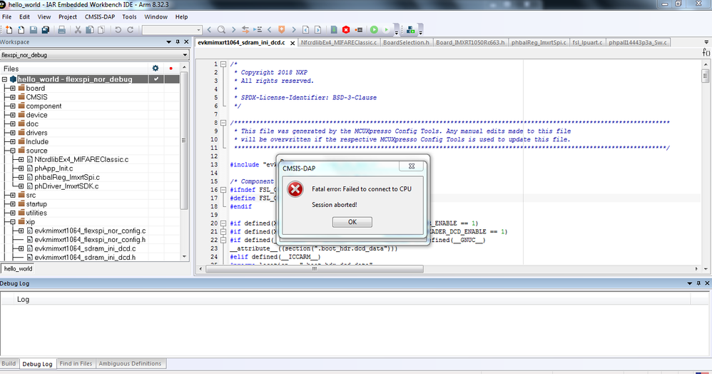

Hello all,
 I have ported NFC reader library code from K82F to IMXRT1064 according to guidelines.
After successful porting, Everything is working well, Card detection, Read & Write is working.
But once I downloaded this code, I am not able to download any other code again.
I am using IAR Embedded Workbench IDE. It shows error 'Failed to connect to CPU' when try to download any code and I have attached a screenshot of error for reference.
Looking for your support.
Sagar

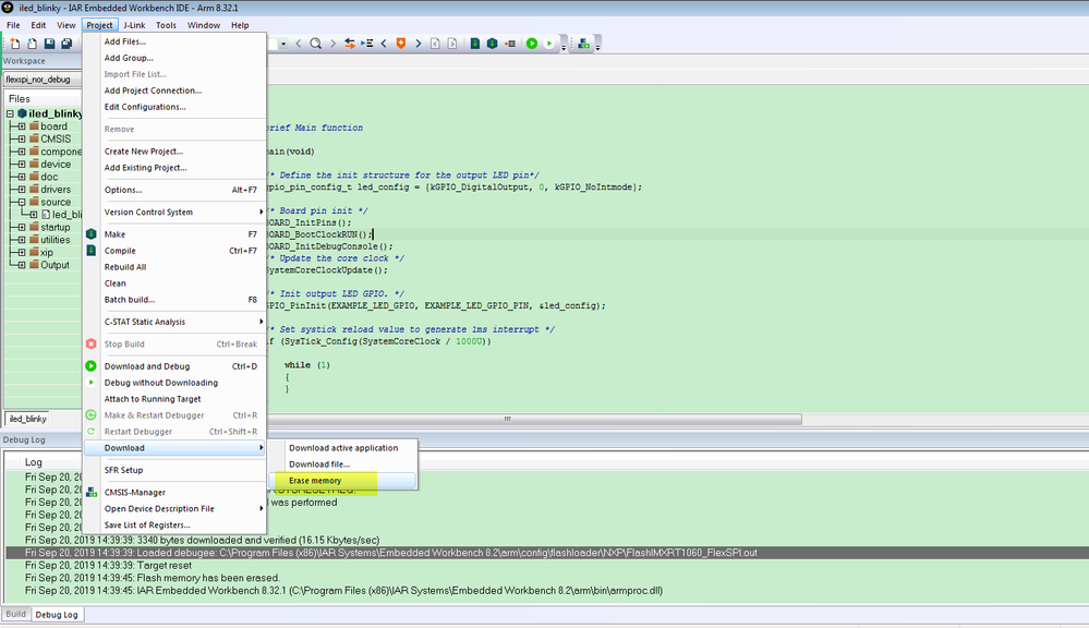

Hi Sagar Prajapati ,
   About the RT problems, you can try to erase the internal flash, please refer to the following picture:  pastedImage_1.png
If you still can't make it work, you can change the BOOT_MODE to serial download mode, then do the erase memory again.

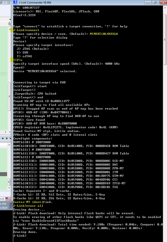

BTW, JLINK commander also can do mass erase:
Wish it helps you!
