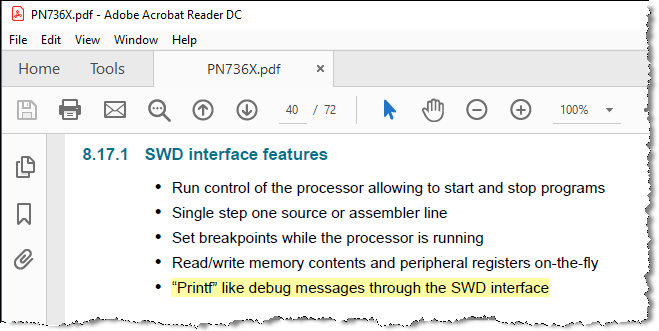

I have a NXP EVM board with following setup.
- NXP PN7362 WLC Poller V3 EVM Board (L102379)
- NXP LPC-Linkn2 debug probe (OM13054)
- Keil uVision 5.22
- WLC-SourceFiles_RC3_v07.01.00_20190410.zip reference code
I confirmed that reference code runs on EVM without any problem.
Now I want to print debug message in Debug Viewer using printf function. But failed to search the correct guide for this issue.
Only I found manual page using ITM port at http://www.keil.com/support/man/docs/uv4/uv4_db_dbg_printf_viewer.htm
But as far as I know, ITM port supports at Arm Cortex-M3 or over and PN7362 is Coretex-M0 core.
Is there any recommanded procedure or reference page for printf output ?

Please check the debug interface setting in IDE.
