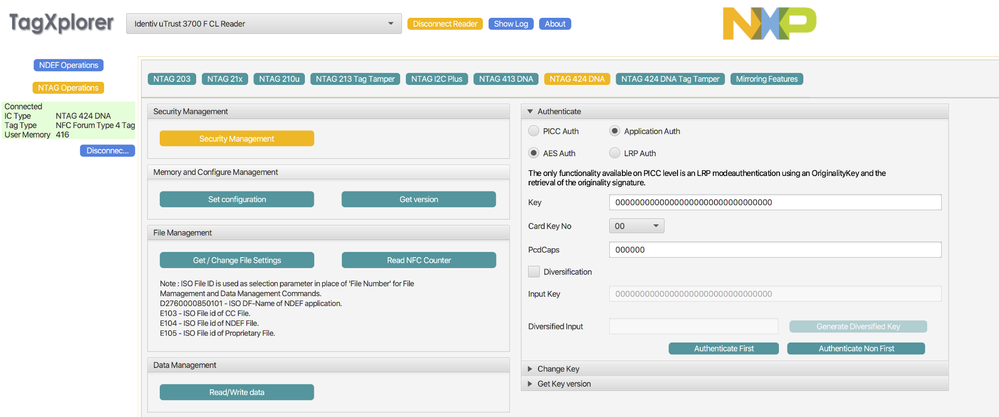

Using this as an example URL, where I have 3 custom params at the end, "n", "t", "p":
my-test-for-tags.com/scan?uid=00000000000000&ctr=000000&cmac=0000000000000000&n=2&t=1&p=3
I activated "ADD TAG UID", "ADD INTERACTION COUNTER" and "ENABLE SUN MESSAGE". I also set the calculated offset Index at 33 which is right after the questionmark in the URL (i hope this is correct?!)
after writing this information to the tag i am going to NTAG 424 DNA Secruity settings where i hit "Authenticate First"
(for this first try i dont want to change any of the default keys on the chip, that would be my next step once i get this simple example working)
After being successfully authenticated
I am going to the "File Management" options and set the following data:
Problem:
When i go now to NDEF Operations and click on READ NDEF button, it will give me for example this URI here:
https://my-test-for-tags.com/scan?uid=044B6A4A4E6880&ctr=000021&cmac=3E12626CBBFB3FB9&n=002&t=1&p=3
if i click the Read from Tag button again it gives me:
https://my-test-for-tags.com/scan?uid=044B6A4A4E6880&ctr=000022&cmac=211167FD30F03BEA&n=002&t=1&p=3
which gives me the same uid, but an incremented counter and a new cmac which i guess is correct.

Do you see any mistakes in my configuration screenshots from the first post? Like Offset numbers, wrong keys, etc?
Please find here again the screenshots:
