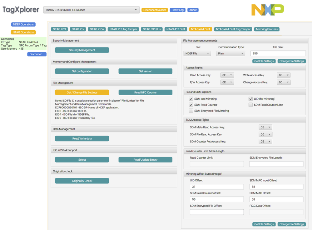

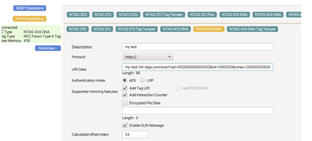

Using this as an example URL, where I have 3 custom params at the end, "n", "t", "p":
my-test-for-tags.com/scan?uid=00000000000000&ctr=000000&cmac=0000000000000000&n=2&t=1&p=3

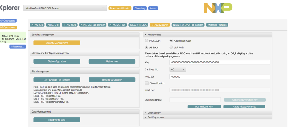

I activated "ADD TAG UID", "ADD INTERACTION COUNTER" and "ENABLE SUN MESSAGE". I also set the calculated offset Index at 33 which is right after the questionmark in the URL (i hope this is correct?!)
after writing this information to the tag i am going to NTAG 424 DNA Secruity settings where i hit "Authenticate First"
(for this first try i dont want to change any of the default keys on the chip, that would be my next step once i get this simple example working)
After being successfully authenticated
I am going to the "File Management" options and set the following data:

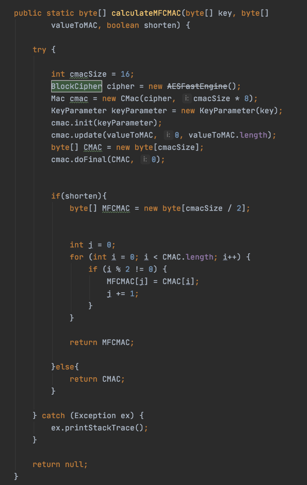

Thanks for your reply, but I already looked at the example from chapter 4.4.4.2 here (https://www.nxp.com/docs/en/application-note/AN12196.pdf )
4.4.4.2 shows the following Java Method:
calculateMFCMAC(byte[] key, byte[] valueToMAC)
1)
which values from the example do i have to use for "key" and for "valueToMAC" to receive the value 94EED9EE65337086 for the CMAC?

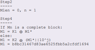

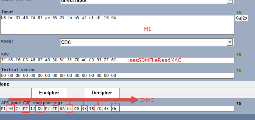

aamirco
Hi @manuel_mertl @Jonathan_Iglesias @IvanRuiz
I am following this guide and i have coded all the parts correctly except for the bit where you calculate m1 value.
I am using the url in the example above so i can verify that the values are correct at each step.
in my server code (i am using nodejs) I have calculated so far that
K2 = 38bc31467d83ae6525fbb5a2cfdf1694
Then in the docs it says
If Mn is a complete block:
M1 = K1 ⊕ M1*
else:
M1 = K2 ⊕ (M1*||10^j)
_________________
Therefore
M1 = b8bc31467d83ae6525fbb5a2cfdf1694
I can see that the 3 from K2 has been replaced with a b in M1, but i dont understand where the b has come from.
before this step i am able to calculate all values correctly. and if i hard code the swap for the 3 to b, then it continues to calculate the final CMAC value correctly. however, the hard code only works for this example of course, when i use a real tag (with a default private key of all 0) and the uid/ctr values are different, it doesnt work anymore, which is expected.
Please could you explain the M1 calculcation step?

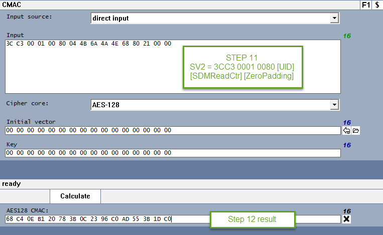

Hope you are doing great, as we discussed in our private messages  please check this :
in the application note you can check 4.4.4.2  this should work for you let me explain how,  there are different ways to do the SUN I will show the first two figures showed in AN.
A.- is the way you are working
B.- is explained in the 4.4.4.2 example.
in this case the UID and CTR are encrypted and sent as "e" Variable.
 since you are sending the information in plain you can skip some steps of table 5.
 so basically you can go directly into  step 11 because the previous steps Decrypt the information and get the UID, CTR, etc. in this case you already have that data because is in plain, so first  you will do the SV2, as explained in  step 11
the  you will need to create the session key for MACing like in step 12
which translates to this
then you will proceed to do the step  13
which I explained in the previous post.
please let me know if this is clear to you or if you have any questions.
Have a nice day !
Jonathan

manuel_mertl
jonathaniglesias‌
Thanks for the answer, but i have some follow up questions to that:

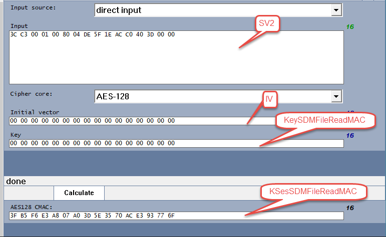

1) is the start of the SV2 value always: 3CC3 0001 0080 no matter what UID and Counter etc. i use? (so can i hard code this part?)
2) When calculating the KsesSdmFileReadMAC ... is this using the calculateMFMAC Java Function?
If so then the key-paramter would be 00000000000000000000000000000000 and the valueToMac-paramter would be 3CC30001008004DE5F1EACC0403D0000 ?
I tried it like this, but it gives me a different value:
I get B5E3073D35AC936F instead of 3FB5F6E3A807A03D5E3570ACE393776F

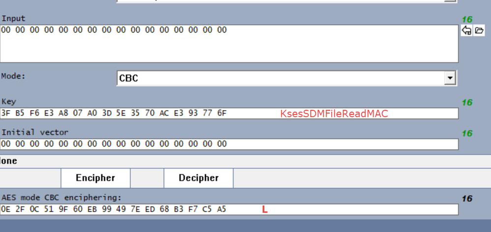

Jonathan_Iglesias
Hi Manuel Mertl,
 for your first question,  the basic answer is yes, this is defined in the DS  section 9.3.9.1
this is the previous step to session keys calculation, the SV1 is used for the session encryption and the SV2 is used for session MACing,  this is not the MAC this is used to generate the key to MAC data during a session. for example next time a customer taps on the tag the SV will change due to the ctr changes,  so each tap will generate a different key therefore a different key for encryption and MAC.
for your second question the calculation should be correct, as you can see in my procedure for step 12 I see your calculations are correct, pastedImage_6.png
as you can see here you split  the key into odd bytes,  the odd bytes are correct so the entire key should be correct, please dont do this here:pastedImage_3.png
  that is done at the end of step 13,  not here,  because you need  the 16 bytes here for the step 13  calculations  as you can see the values on step 12 are used as key on step 13. then the result of 13  is split into odd bytes  to have 8 bytes of data.
Hope I am being clear here if you still have questions let me know. I would highly recommend checking the  process on the DS and AN.
Hope you are doing great.
Jonathan

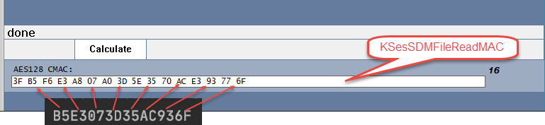

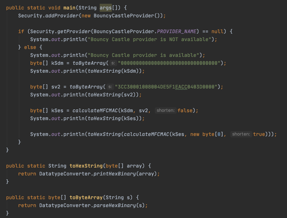

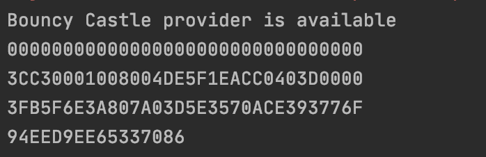

manuel_mertl
Thank you so much for your explanation jonathaniglesias‌, we are nearly there :smileygrin:

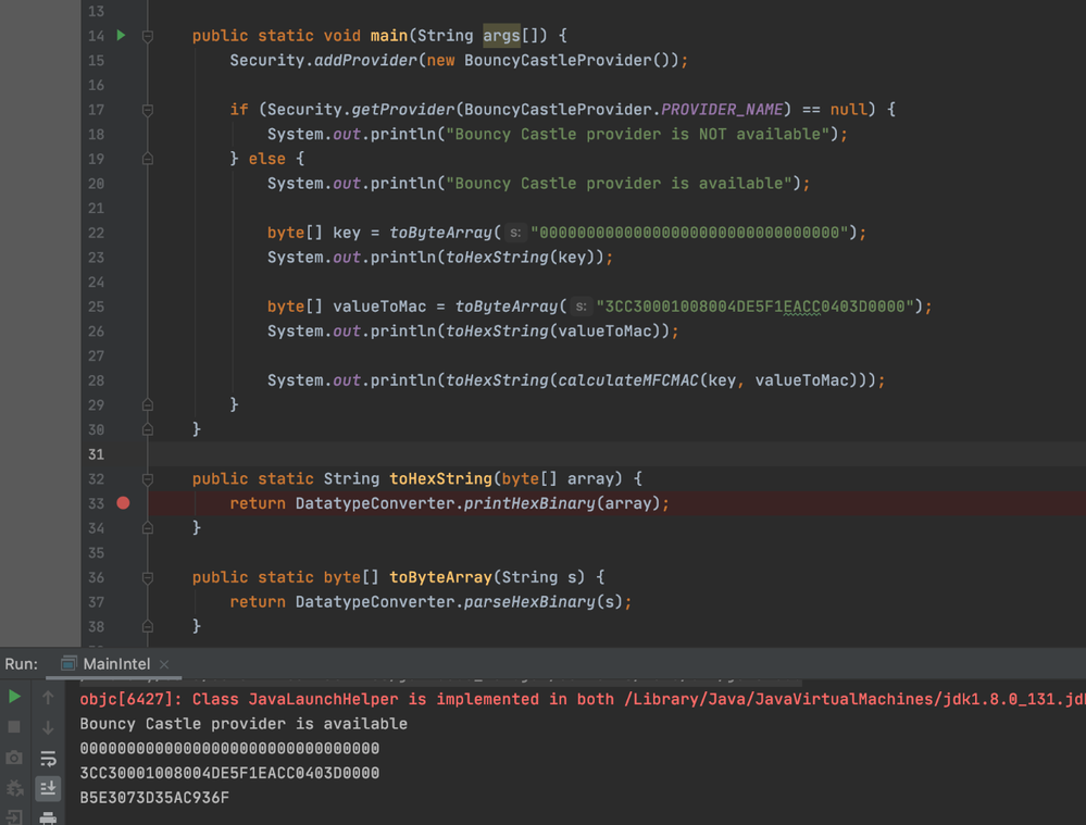

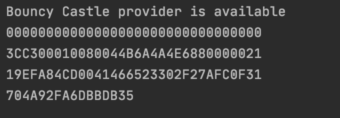

I was finally able to recalculate the values from the document using this code below (for anyone interested):
receiving the folllowing output:
but I tried now to change my value for SV2 according to my first post all the way up here:
so instead of using the following value from the example:
i used the uid(044B6A4A4E6880) and ctr(000021) from my example up there, leaving the other code the same:
which gave me the following result when i scanned the tag itself:
https://my-test-for-tags.com/scan?uid=044B6A4A4E6880&ctr=000021&cmac=3E12626CBBFB3FB9&n=002&t=1&p=3
but my java app outputs the following:
so 3E12626CBBFB3FB9 != 704A92FA6DBBDB35
:smileysad:

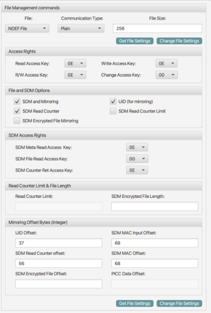

Do you see any mistakes in my configuration screenshots from the first post? Like Offset numbers, wrong keys, etc?
Please find here again the screenshots:

Jonathan_Iglesias
Well in this case specifically  I do not know how to calculate this because I dont have the actual data, as you know every time you tap into your tag, there is some dynamic data that will be generated, so each tap there should be a different session key and I do not know the keys you have stored internally in the tag and please do not share them here since this is a public forum you dont want your keys posted here, the best would be that you apply this process to the tag or if you want you can do a dummy test where you do all the process with dummy data and keys but the best would be that you know your keys and apply the process that I have explained in my previous post here.
just take the ctr and UID and apply step 11, then step 12 to get the session mac key then the step 13 to get the mac,  it is important that you do this with the correct keys the ones in the app note are just for demonstration.
Jonathan

manuel_mertl
jonathaniglesias‌, IvanRuiz‌
for testing purposes, i have not configured any of the keys yet on the tag.
if i understood correctly everytime i tap the tag in my case only the ctr-value and the cmac-value changes, correct? (since the UID stays the same), see my URL strucutre below
then i am creating the SV2 value by concat: "3CC3 0001 0080" +  UID +  CTR
which gives me: 3CC300010080044B6A4A4E6880000021
and then i am using my code from above calling:
calculateMFCMAC(byte[] key, byte[] valueToMAC);
where the key equals the 32 zeros and the valueToMac equals my SV2 as byte arrays
so if the default key on the tag is 32-zeros then it should work, correct? ( -> but it doesnt)
maybe you can see some of my configuration problem in the above screenshots?

manuel_mertl
Thank you, jonathaniglesias‌
I think I see now where my mistake is:
My uid is 044B6A4A4E6880 and my ctr is 000021
Then i am creating the SV2 value by concat: "3CC3 0001 0080" +  UID +  CTR
Which gives me: 3CC300010080044B6A4A4E6880000021
but instead of using this value, your value looks like this:
3CC300010080044B6A4A4E6880210000
so you remove the leading zeros and add them at the end.
Thank you!
