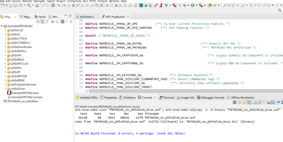

Seems I am missing something basic - and any of your suggestion would help me a lot.
I have recently purchased OM27462CDKP development kit. Downloaded the FW and SW full examples from https://www.nxp.com/products/rfid-nfc/nfc-hf/nfc-readers/nfc-controller-development-kit:OM27462CDKP ...installed MCU Expresso and imported these example files, and build all - it looks like as below.
Now I am stuck on
a. Which file I need to download to the board
b. How to download the code
My configuration looks as below
when I try to run the code by clicking on green "Play" button in the IDE, I get below errors.
Error starting process.
Cannot run program "...\NxpNfcRdLib_PN7462_v06.10.00_Pub\ExamplesPN7462AU\phExMain\mcux\DebugPN7462AU\PN7462AU_ex_phExMain_mcux.axf": Launching failed
Cannot run program "....\NxpNfcRdLib_PN7462_v06.10.00_Pub\ExamplesPN7462AU\phExMain\mcux\DebugPN7462AU\PN7462AU_ex_phExMain_mcux.axf": Launching failed
Basically my requirement is to send some APDU commands and accordingly set some LED's.

Hi @phanids :
For downloading a project, I would suggest you use a MCU PRO link or LPC-LINK 2 , please refer to AN 11022.
section 5.5  Running and debugging a project
Though this application note for RC663, it also applies to PN7462
https://www.nxp.com/docs/en/application-note/AN11022.pdf
