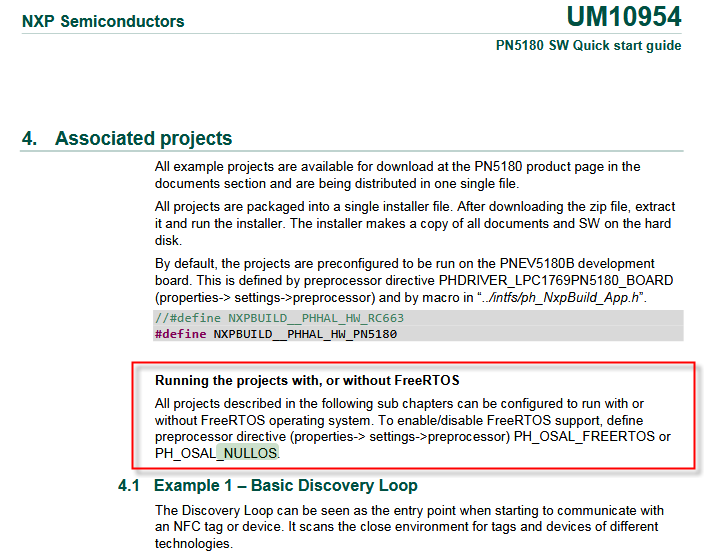

I'm trying to work without an OS on my LPC1769 which I use with PN5180 and developping on MCUXpresso.
I saw this post https://community.nxp.com/thread/439690 but I can't find the macro #define NXPBUILD__PH_OSAL_NULLOS to enable in the file ph_NxpBuild_App.h. When I use the Search tool I got no occurence in the whole workspace.
What is the procedure to use the NullOS ? Apart from enabling the macro I know that I have to exclude the FreeRTOS directory from building, what else should I do ?

Hello Emma,
Did you download the latest NFC reader library? If yes, you should download the latest quick start guide as well. Please kindly refer to the following for details.
Kan
