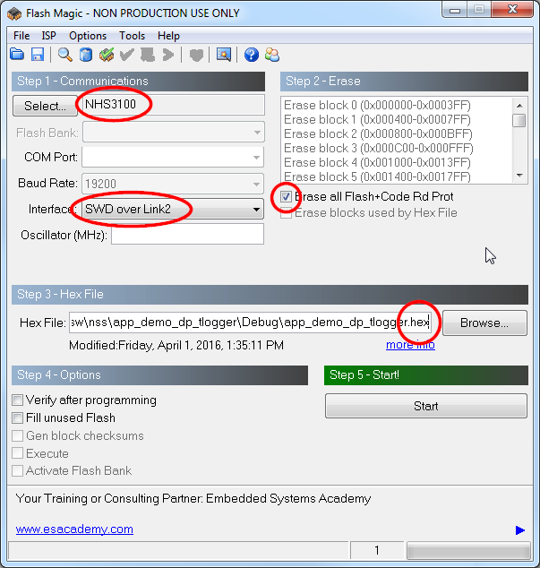

Trying to reprogram to the NHS3100 which came with the Temperature Logger ADK using FlashMagic (version 10.55.4768 on PC-windows7). The FlashMagic interface button does not have the required SWD Link item. What now?

This picture is copied from the Getting Started guide UM_NHS31xx_GettingStarted.pdf in the SDK, page 8:pastedImage_2.png
Which settings are you unable to replicate?

Hi. My problem is solved now. The issue was that FlashMagic was not configured with the SWD Link interface at first install. I had to reinstall after connecting the NXP board.
