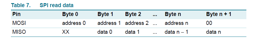

I have following results:
0x10 - 0x00; 0x11 - 0x00; 0x12 - 0x58; 0x13 - 0x3F; 0x14 - 0x3F; 0x15 - 0x19; 0x16 - 0x13; 0x17 - 0x00.
According to the data sheet, after reset, registers should look like this:
0x10 - 0x80; 0x11 - 0x58; 0x12 - 0x3F; 0x13 - 0x3F; 0x14 - 0x19; 0x15 - 0x13; 0x16 - 0x00; 0x17 - 0x00.
It seems like the result set is right shifted by one. What could be wrong with my setup?

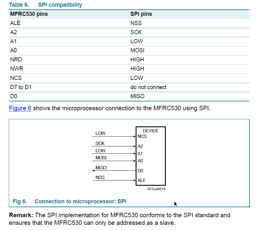

Table 34. Dedicated address bus: assembling the register address
Register bit: UsePageSelect    Register address
1                                                  PageSelect2 PageSelect1 PageSelect0 A2 A1 A0
LPC2103 P0.4 connected with MFRC530 A2 (SCK0)
LPC2103 P0.5 connected with MFRC530 D0 (MISO0)
LPC2103 P0.6 connected with MFRC530 A0 (MOSIO0)

bunny_stew
Hello Kan,
I tried to read n bytes and now it works. I just missed n + 1 byte, it must be 0x00. After receiving data on MISO first byte is ignored and I have nice array of requested bytes.
Thanks anyway.

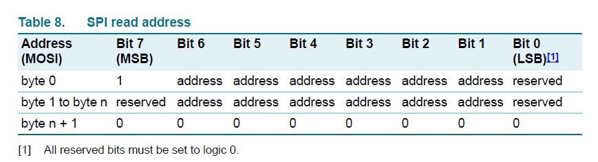

I am not the expert for LPC, but for MFRC530 SPI reading, it should be like that:
Please check if you read the data out in the right sequence.
The address byte must meet the following criteria:
• the Most Significant Bit (MSB) of the first byte sets the mode. To read data from the
MFRC530 the MSB is set to logic 1
• bits [6:1] define the address
• the Least Significant Bit (LSB) should be set to logic 0.
The Page register is just for interfacing with Parallel Port, but since you are using SPI communication, it is disabled.
Please also check if the SPI connection is following as it is in the data sheet.
