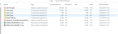

Can I use the Gerber files provided along with NXP NTAG I2C NFC IC as it is without making any modifications to them ?
Can I use them on different substrates ? how much performance degrade will be there ? How to overcome those ?

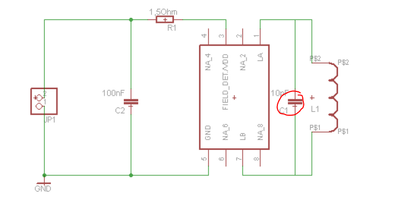

Anyhow, once you produce the antennas, it is recommended to measure them with the help of the VNA and potentially tune the tag by a parallel capacitor as shown below.

Hello EthanMathew25
Do you mean the following files located in AN11276?
Tomas
4,088件の閲覧回数
EthanMathew25
yess! those files...
can I use them on any substrate or do I have to make any changes?

Tomas_Parizek
Hello EthanMathew25,
What substrate are you planning to use?
Yes, as the antenna turns are only on one layer, the different substrates should not have any major impact.

EthanMathew25
Polyimide substrate
4,039件の閲覧回数
Tomas_Parizek
Ok, it should be fine.
