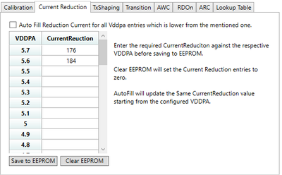

I'm attempting to create a DPC Lookup Table with NFC Cockpit.  My board comprises a K8x, SPI connected PN5190, and my own tuned antenna.  I have ported the board firmware (VCOM/UcBalFW v03.08.00) to my board, and can successfully control the PN5190 with the NXP NFC Cockpit V6.7, V6.8 or V7.1 Windows application. In addition I have a Dobot Magician Robot, Oscilloscope, and EMV approved PICCs.
I am using Renke Bienert's PN5190 Dynamic Power Control Quick Calibration and TxShaping Demo to perform the DPC calibration.

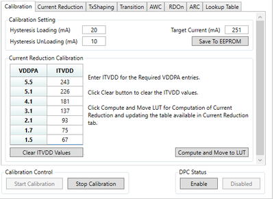

With the PICC positioned at 4.0.0 (4cm, center), and VDDPA at 5.7V maximum I get a transfer power measurement of around 3.4V with a TxLDO current (ITVDD) of  251mA, which is the Target Current that I saved to the EEPROM.
Going through the procedure of 1) reducing the VDDPA in steps, 2) lowering the PICC closer to the antenna until the target power transfer of 3.4V is measured, and 3) entering the ITVDD for that VDDPA; I end up with the following:
Now, when I click [Compute and Move to LUT], only the first 2 entries are populated:
The demo video instructs me to interpolate the 'in-between' values in the current reduction table, but the data is too sparse to do so.  Not even the corresponding VDDPA entries (5.5, 5.1, 4.1, 3.1, 2.1, 1.7 and 1.5) are populated.

Hi Kelly,
I agree with your annotation "...does not match the actual situation at all." That's the whole point. I'm trying to figure out why NFC Cockpit failed to generate the current reduction entries correctly.  I would expect at least the 5.7V entry to show a current reduction of 0.
You may have noticed that I have a 3.4V power transfer target, instead of the much higher 6V+ that Renke recommends. I'm deliberately throttling back on the target current from a possible max of about 300mA down to 251mA to avoid a PN5190 over-temperature condition. Could this be causing the the calculation issue?

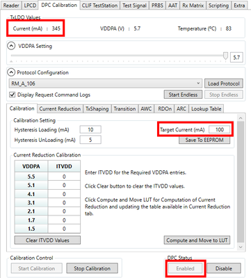

Hi @KaiLi
NFC Cockpit. Target Current set to 250mA  &  DPC Status [Enabled]
If I move the PICC closer to the PCD the current exceeds 250mA.  I thought that the Target Current was the maximum limit. I even tried setting the target to 100mA and lowered the hysteresis values to see how the DPC would behave. The DPC does not appear to be working at all!

KaiLi
Hello @deniscollis
Therefore, it is highly recommended that you calibrate over the full range of voltage to make the DPC conform to a normal logic. The calibration process is very brief, and that little time of high current will not cause overheating (The PN5190 can drive up to 2W at 5.7V@350mA). After the calibration is complete, if you are worried about overheating when your device is running normally, you can take some measures to limit the maximum power output. You can refer to Section 2 of AN13669 for details.
From theoretically and practically, after correct calibration and enable the DPC function, the current will not exceed the target current what you set. So, another suggestion to you, if possible, please running the complete logic of DPC using NXP's development board first.

KaiLi
Hello @deniscollis
Thanks for contacting us and choosing the NXP products.
Based on your present information, there are some comments as follows:
1. Did you tune your antenna? Before DPC calibration, antenna need to be tuned.
2. Are the calibration methods and steps correct? Judging from the point-by-point calibration value, the calibration result is inaccurate and too far from the target value, especially the last few points. The value of each calibration point should be very close to the target value.
3. Please check the below fig:
So, based on the above comments, it's strongly recommended that that you re-calibrate your device strictly according to Ranke's video.
