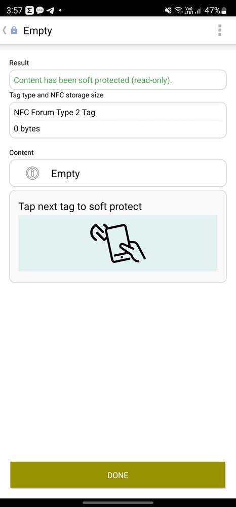

Hello
I am facing issue while doing password protect on NXP tagwriter android application. my tag gets detected, normal read/write works, soft protect also works but when I try doing password protect it gives me error saying "Store failed. Not valid NTAG21x product".
please someone give me suggestions.
Note: I am using unused tags, device used is Samsung S23 ultra
below attached is image for your referenceScreenshot_20230615_155725_TagWriter.jpgScreenshot_20230615_155738_TagWriter.jpg

Hello @avtar9823
Thanks for contacting us and using the NXP products.
According to your issue description, "soft protect" means you lock some blocks, right? if so, authentication is first required and then the card can be accessed.
Please don't hesitate to contact us if any questions.
