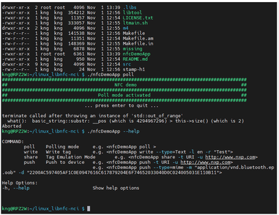

When compiling I get the following error:
And after a minimal fix it fails to run with this error:
Any thoughts? I've done a "apt-get update" and a "apt-get upgrade"
--Ken

FYI. There is a patch.
https://community.nxp.com/t5/NFC/Linux-NFC-library-build-error/td-p/1899644
