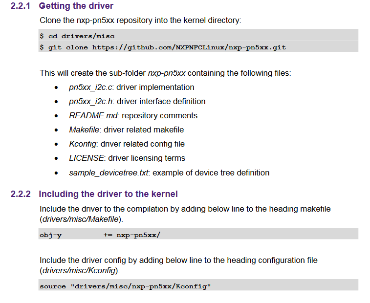

I have PN7150 NFC Controller SBC KIT for Arduino. I want to enable PN7150 NFC controller, the opensource driver that I could locate is nxp-pn5xx/pn5xx_i2c.c at master · NXPNFCLinux/nxp-pn5xx · GitHub
So Does this driver is sufficient to enable PN7150. Actually the driver belongs to pn5xx family but the controller that I am having is pn7xx family ..

Hello Bhaskar,
    About how to get pn7150 driver, refer to AN11690, please! let me attach it here!
Hope above information can help you!
