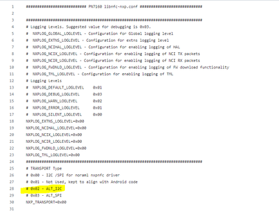

paweljasinski
The setting are correct. I will attach strace log which shows opening /dev/i2c-1
13,800件の閲覧回数
paweljasinski
here is the relevant snipped from the config. The config was changed before building.
NXP_TRANSPORT=0x02
# Nfc Device Node name
NXP_NFC_DEV_NODE="/dev/i2c-1"
The strace file shows that the correct file is open. I have selected only the log from interesting thread.
The command was: "strace -ff -o strace.log nfcDemoApp poll"

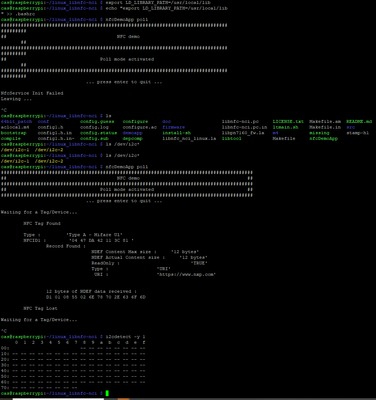

Tomas_Parizek
Hello Pawel,
I just tested with the Raspberry Pi on my side
I exactly followed the instructions listed in the App. Note you have mentioned.
Here is the result:
You can see that for the first time, I also got the "NfcService Init Failed" error message as you.
So I removed the PN7160 from the socket and put it back + I checked if the I2C was enabled.
Then the NFC application started to work as you can see in the picture.
Here is the information about HW that I am using:

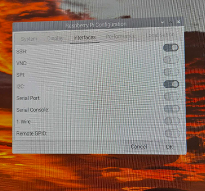

Also, one more thing I did at the beginning. I enabled the I2C in preferences:
Tomas

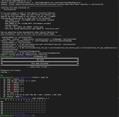

Stephan_B
Hi @Tomas_Parizek
I have the same issue. I've checked the I2C, unplugged and rebooted multiple times but I always get the "NfcService Init Failed". Do you have any more suggestions I could try to get my setup running?
The error message is the same whether the OM27160 is plugged in or not. Is there a easy way to verify whether the PN7160 is responding? Maybe my hardware has some defect?
Stephan

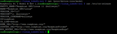

Stephan_B
Hello @Tomas_Parizek
Today, I got my setup working. I had to install an old Rasbian version (bullseye) and then it compiled without error and it works.
Would have been nice to have some pointers in the "get started guide" concerning which OS / HW versions this has been tested with.
Stephan

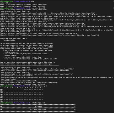

mikytron98
Setup Details:
  • Raspberry Pi 5 running Debian (kernel 6.12.25+rpt-rpi-2712, aarch64)
  • Using linux_libnfc-nci library for NXP NFC chips
  • I2C enabled with buses at /dev/i2c-1, /dev/i2c-13, /dev/i2c-14
Current Issue:
  • sudo i2cdetect -y 1 shows no devices (all "--")
  • nfcDemoApp compiles but fails with "NfcService Init Failed"
  • Also getting C++ std::out_of_range exception in strings.cpp
The I2C scan suggests no NFC hardware is detected on bus 1. Either the module isn't connected properly or I2C isn't configured correctly for the NFC chip.
I made progress when I used a forked branch of the source code but it seems you guys have a version of the source code that works saved privately somewhere based on another conversation I saw @danielchen reply in

Stephan_B
I used a tried with a Raspberry Pi 5 as well as with a Raspberry Pi 3 B+. I tested both 32 and 64bit versions. Though when compiling for the 64bit version I needed to correct some of the code as I later found in the 64bit patch file.
I then assumed, that it is a HW problem, as I can see the I2C signals being sent with the oscilloscope. So I bought another EvalBoard, but it still not working.
"Leaving ..."
is all i get. As for the OS, I am working with Rasbian. I use the Raspberry Shield, that came with the Developmentkit and setup/installed everything via the Terminal (SSH/Putty)
Regards Stephan
