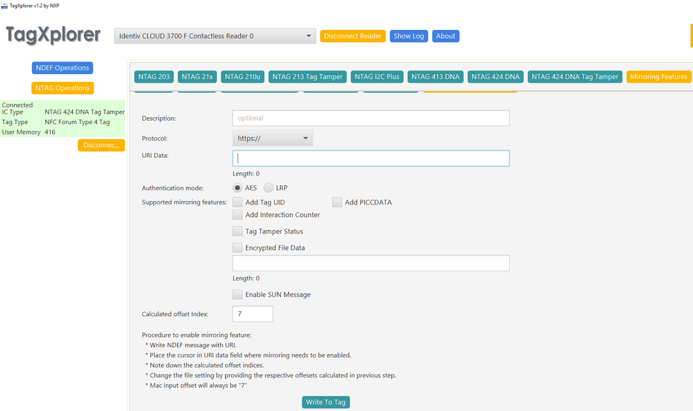

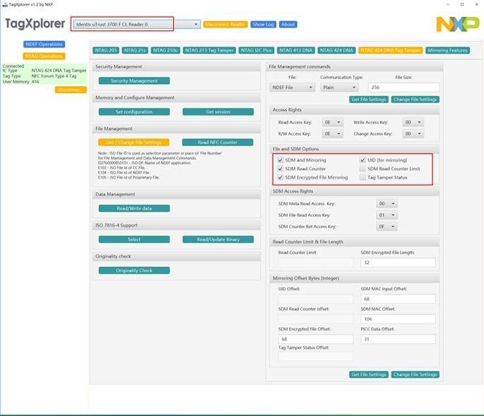

   I have a trouble in decryption of SDMENCFileData, I could get the same data with the Table 4 of 4.4.3.2 Decryption of SDMENCFileData of AN12196, while when I write the demo url = https://my424dna.com/?picc_data=00000000000000000000000000000000&enc=7878787878787878787878787878787... into the tag,enable the mirror feature, and read the tag,I got the new url = https://my424dna.com/?picc_data=E704C53A168DCD09F9E9A86D93BA3037&enc=570296360EBE9656E25A734840C5439.... After the same decryption process, and I get the decryption SDMENCFileData = 37383738373837383738373837383738, which is not equal raw enc=78787878787878787878787878787878, and is the ASCII format. Even I transform the data "37383738373837383738373837383738" into ASCII format "7878787878787878", it only 8 byte length and only the half of the raw enc. Below is my computational process and tag setting, could you help me work out the problem.

Tag Setting:

Hi Long,
How did you write to the tag for the Mirroring features? I may try to reproduce this issue here.

Hi Kan,
  Thanks for your reply, please refer to the attachment for tag writting log, and my concern is that why the plaintext(after decryption) of SDMENCFileData is ASCII format, and only the half of the raw data.
