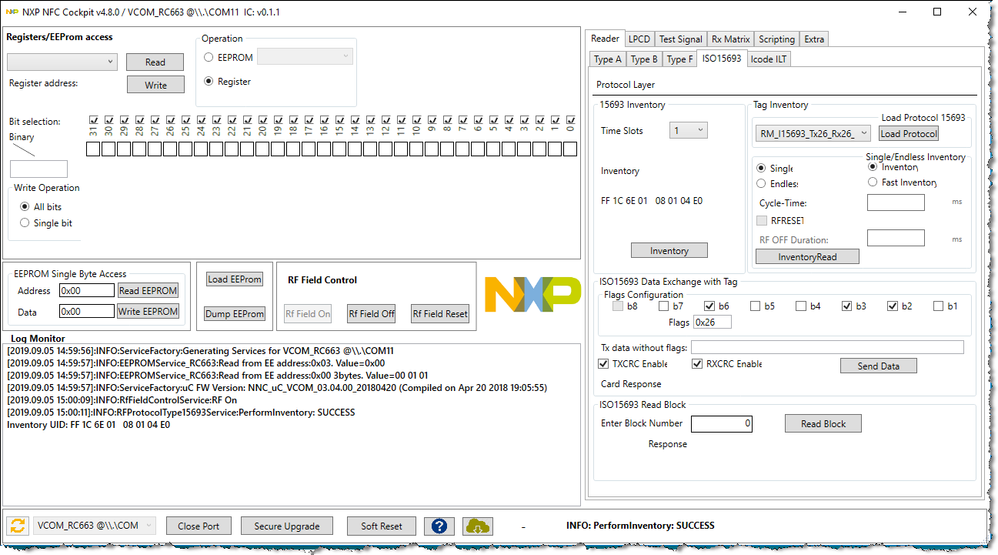

I am using CLRC663 evaluation board and try to use this board to read the UID of the tag with ISO15693. I loaded the secondary firmware file(nnc.bin) to the NXP NFC Cockpit, but I failed and the software does not work anymore. I tried to install it again but It still does not work. I think that I have loaded the wrong file to the board. What should I do?

Please flash LPC firmware by refer: Program the firmware to PNEV5180B board
Since you are using CLRC663 evaluation board, the firmware can be found in C:\nxp\NxpNfcCockpit_v4.8.0.0\firmware\Secondary_RC663\BootLoader_And_Nfcrdlib_SimplifiedAPI_EMVCo_Secondary.bin
Then CLEV6630B will be able to connect to Cockpit again.

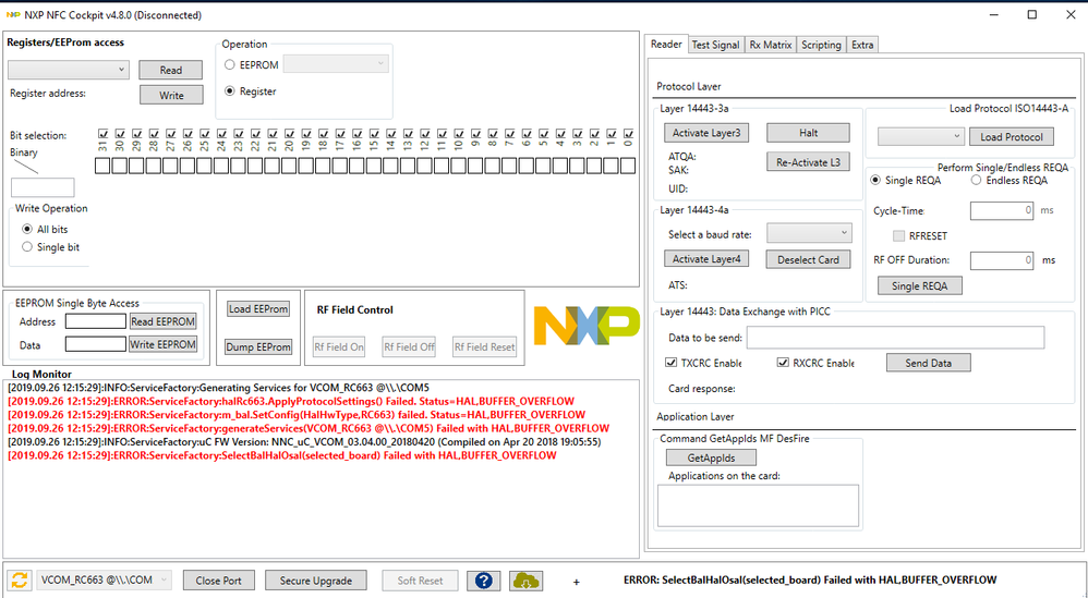

hi Robin,
After I flash the LPC FW, it comes to another error and it is still disconnected.error2.png
