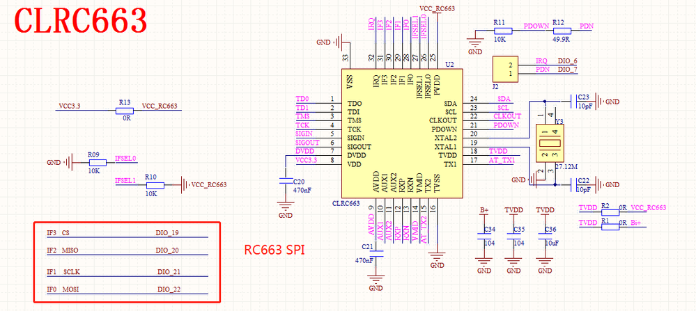

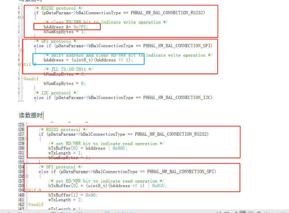

CLRC663 hardware connection mode is SPI

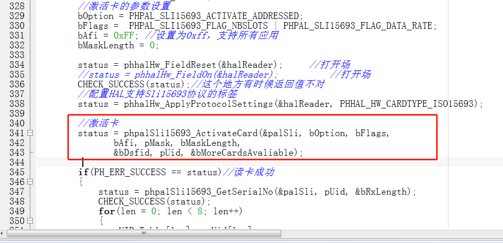

The code in the red box as shown in the figure has encountered a problem.
The code provided by NXP.Hello, the problem is this: the original solution
was STM32+RC663. All functions are normal.

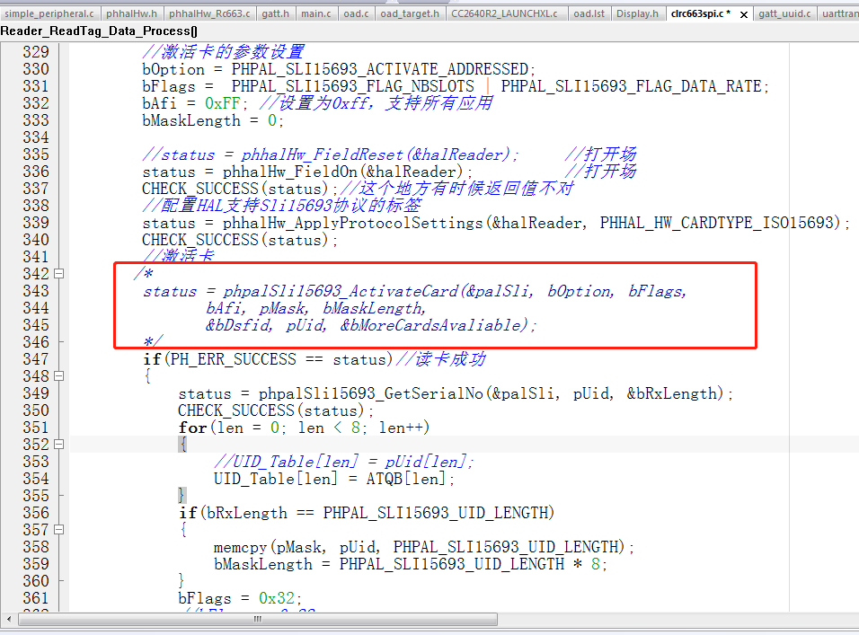

Now it is changed to the solution of CC2640+RC663, which can be used as a
card reader to read data of a TAG and write data to the tag. There is a
problem with calling the activation card function:
       / / activate card function
       status = phpalSli15693_ActivateCard(&palSli, bOption, bFlags,
                                                                    bAfi, pMask, bMaskLength,
                                                                    &bDsfid, pUid, &bMoreCardsAvaliable);
Every time this function is called, CC2640 (Microcontrollers) will crash, it doesn’t work.
If this function of the activation card is blocked, there will be no problem.
because the UID of the tag must be obtained by activating this function of the card,
this function of the activation card directly calls the code of NXP,  I don't know how
to solve this problem.
1.Find only the script in serial mode, and want the simple operation register in SPI mode
to get the reference code of UID.
2. Want to know if NXP has a simple protocol command document for registers, so you
can write your own code to get the UID of the tag.
3, whether this activation function takes up memory and has a large array, causing the
Microcontrollers(CC2640) to crash, or it can be solved by modifying the code in this function.
Look forward to your reply.

Kan_Li
The SPI and RS232 are just host interfaces which can be selected by the pins of IFSEL0 and IFSEL1, so it doesn't affect the register settings, you may still use the same process like what you have done.
Hope that makes sense,
Kan

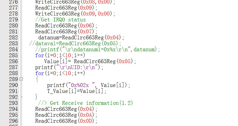

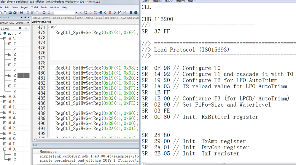

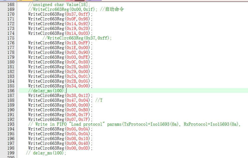

1299457179
RS232模式下操作寄存器和SPI模式下操作寄存器,不是一样的。我们当做一样的处理,完全不行。查看RC663库函数的代码,发现了如下的区别。
按照这个区别,我们修改了代码,在SPI模式下,直接操作寄存器,如下图所以。目前只能打出场,也获取不到标签的UID。
现在不知道如何做了。有没有正确的在SPI模式下的,直接操作寄存器的方法来读取15693协议标签的UID和读写指定地址数据。
期待你的回答。

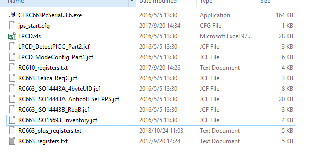

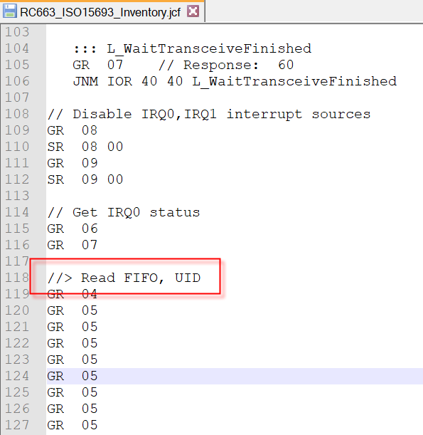

Kan_Li
We have script files working with CLRC663 based on PC serial tool, and there is an example for ISO15693, please kindly refer to https://www.nxp.com/downloads/en/software/210910.zip  for details.
Hope that helps,
Kan

1299457179
Thank you for your reply
Now the activation function is not working properly, other normal.
Data can be written and read by SPI normally.
So I don't know what to do now.
Because the RC663 library is transplanted on CC2640 and the development environment compiles the code.
There was no prompt for insufficient SRAM.
So I'm not sure if CC2640 (microcontroller) is running out of SRAM.
In addition, I need SPI mode, directly using registers to write code.
So you don't need too much SRAM. The script in RS232 mode is not applicable.
It should be noted that, as shown in the figure, the tag can be read normally by removing the part of the activation function.
Data, and write data to labels. But you can't get the UID of the tag.

Kan_Li
If the same code can run on your original solution, the problem should not be in the software, I think the difference between STM32 and CC2640 is the root cause if you only replace STM32 with CC2640 in the hardware.
Kan

1299457179
In SPI mode, the UID of the label is obtained by directly manipulating the register.
Is there a reference in SPI mode?
16,135 Views
1299457179
If it is caused by the difference between STM32 and CC2640.
Now we need to solve how to get the UID. We want to get the UID by directly manipulating the registers. Is there any reference in SPI mode?
16,135 Views
Kan_Li
Did you ever download the script file I mentioned above? It is just the reference you are looking for. Please refer to the following for details.
Kan

1299457179
Previously, scripts were used in RS232 mode.
Now, we need the way registers operate in SPI mode.
16,135 Views
Kan_Li
CC2640 has not been supported by the latest NFC reader library, so I think it should be some porting issue, maybe due to the memory resource is not enough to run the library. For LPC1769, it has 64KSRAM, but CC2640 seems just has 28K. That might be the root cause.
