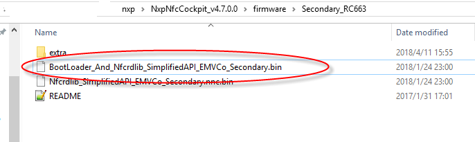

I have a CLEV6630B and it seems to be in a stuck or looped state, it will not connect or is recognized by my computers USB port any longer. Is there something I can try?

Hi Jackson,
Did you program the board with correct firmware? If you use cockpit with it , you may find the firmware in the installation folder as below:
To download the firmware, please refer to Program the firmware to PNEV5180B board for details.
