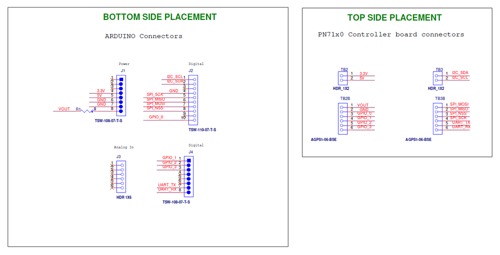

3. Connection between i.MX6ULL EVK and the PN7160
There are some pins on the Arduino header on the i.MX6ULL EVK board can be used to connect the PN7160 board. Below is the schematic of the Arduino headers on the i.MX6ULL EVK board. The two I2C2 pins can be used for I2C connection. The UART2_RX, UART2_TX and UART2_RTS can be changed to GPIO for connecting IRQ, VEN and DWL_REQ of PN7160, respectively.
Below is the J1704 and J1703 on the EVK board.

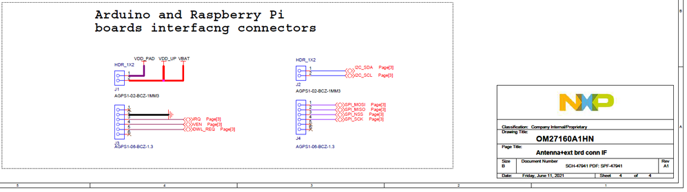

Below is the schematic of Arduino interface on OM27160A1HN.
There is a connector board (OM29110ARD-B). The OM27160A1HN is connecting on top of it. Below is the connectors board schematic.
So, on the i.MX6ULL EVK board, we need I2C2 SDA and I2C2 SCL for I2C connections. And 3 GPIO pins for PN7160's IRQ, VEN and DWL_REQ.
Here is the connection between i.MX6ULL EVK and OM29110ARD-B.
OM29110ARD-B | pin | i.MX6ULL EVK | pin |
I2C_SCL | J2-1 | I2C2_SCL | J1704-10 |
I2C_SDA | J2-2 | I2C2_SDA | J1704-9 |
GPIO_0 | J2-10 | GPIO1_21 | J1703-1 |
GPIO_1 | J4_1 | GPIO1_20 | J1703-2 |
GPIO_2 | J4_2 | GPIO1_25 | J1703-3 |
3.3V | J1-4 | 3.3V | J1705-4 |
5V | J1-5 | 5V | J1705-5 |
GND | J1-6 | GND | J1705-6 |

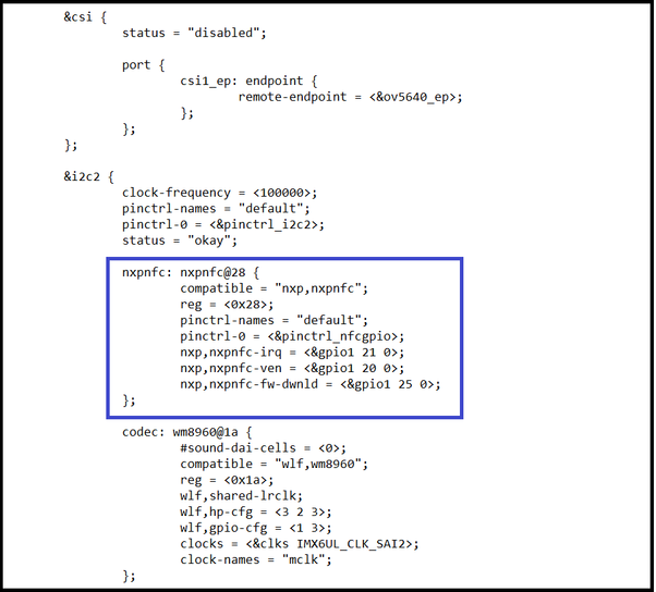

Put the below nxpnfc under the &I2C2 node.
nxpnfc: nxpnfc@28 {
compatible = "nxp,nxpnfc";
reg = <0x28>;
pinctrl-names = "default";
pinctrl-0 = <&pinctrl_nfcgpio>;
nxp,nxpnfc-irq = <&gpio1 21 0>;
nxp,nxpnfc-ven = <&gpio1 20 0>;
nxp,nxpnfc-fw-dwnld = <&gpio1 25 0>;
Like this:
Add the gpios for nxpnfc.

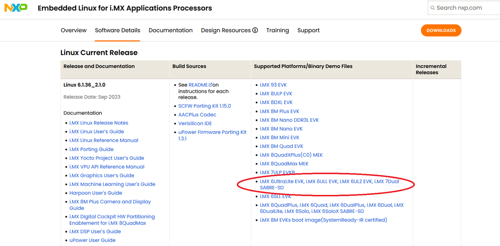

Download the Demo image for i.MX6ULL EVK from the Linux BSP web page.
Unzip the demo image file to a folder. And then copy the UUU.exe to the same demo image folder.

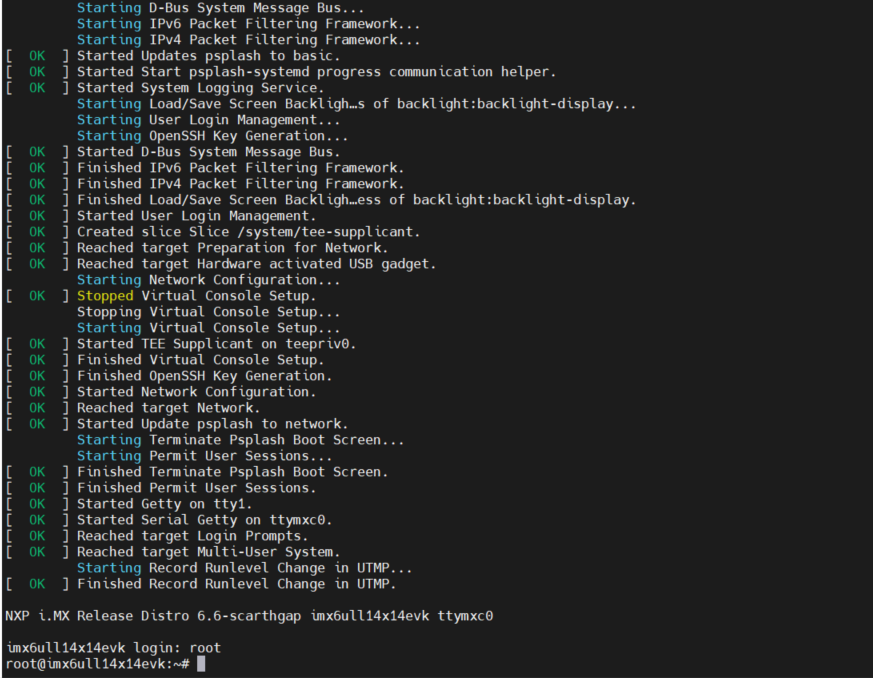

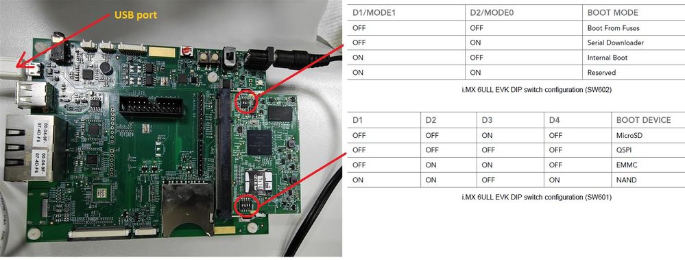

Connect the board to your PC using the USB cable. Switch the boot mode to "Serial Downloader mode"
On the PC side, run the below command to program the image to SD card on the i.MX6ULL EVK.
uuu -b sd_all core-image-full-cmdline-imx6ull14x14evk.rootfs-20241112083235.wic.zst
Then switch the boot mode to "Internal Boot (Development)". Restart the board.

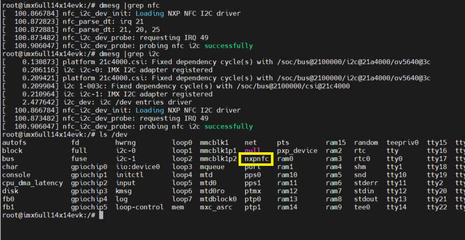

Now, you can login as "root" and use the board.
And you can see the nxpnfc driver is properly loaded.

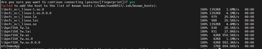

L6.6.36_2.1.0/build-for-6ullevk/tmp/work/cortexa7t2hf-neon-poky-linux-gnueabi/nxp-nfc/git/

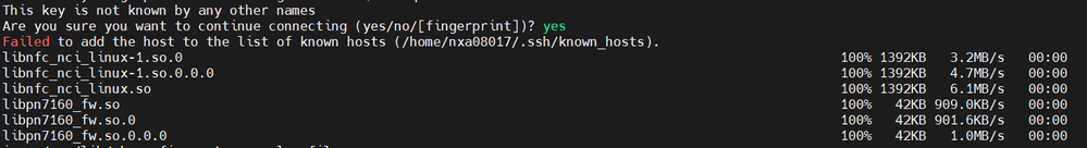

Use the "scp" command to copy the files to the EVK board via the Network. If the folder is not exist on the EVK, please use "mkdir" to make the folder on the EVK first. Then use the "scp" command.
Here is the example: (**The IP address below should change to your EVK's IP address.)
scp build/.libs/* root@10.192.246.136:/.libs/
scp image/etc/libnfc* root@10.192.246.136:/etc/
scp image/usr/lib/* root@10.192.246.136:/usr/lib

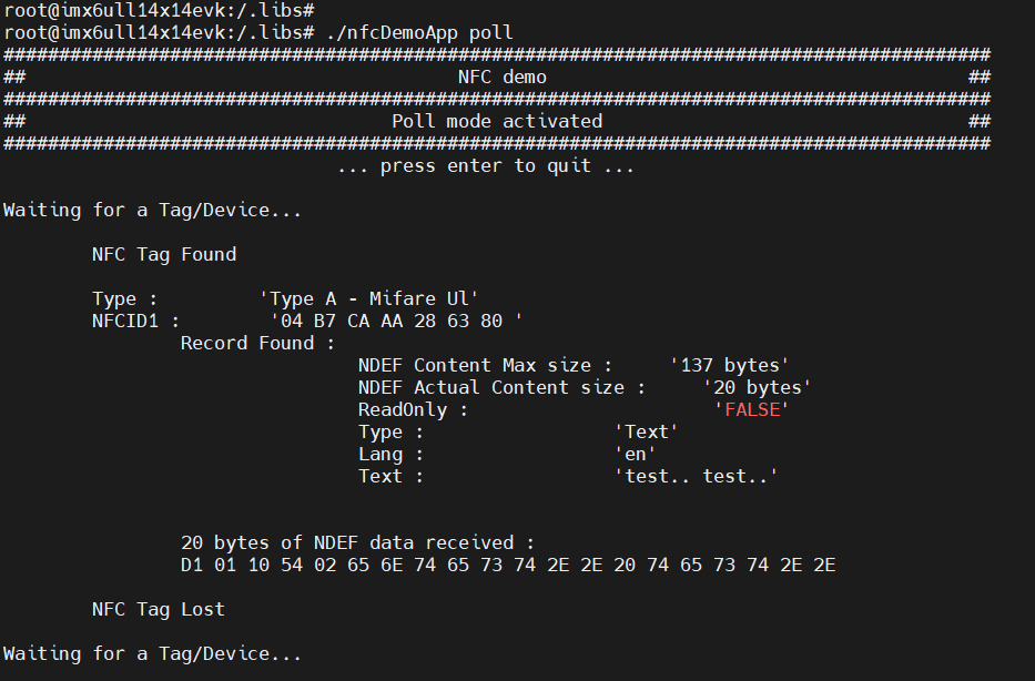

Now, you can run the nfcDemoApp on the i.MX6ULL EVK.
root@imx6ull14x14evk:/# cd .libs/
root@imx6ull14x14evk:/.libs# ./nfcDemoApp poll
