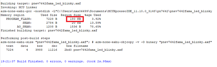

Step 1: compile pnev7642fama_led_blinky demo
Please make sure the flash size is 180KB.  By default,  the output flash size is 180KB with MCUXpresso IDE.

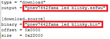

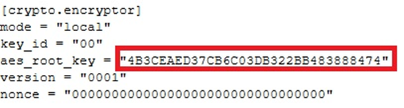

To run this utility, the toml file is very important.  You need to change the output name and binary name according to your project ,  and  you need to use the correct aes_root_key. For other parameters, we left them unchanged.
3.1   change the output name and binary name
3.2 set the correct aes_root_key

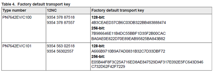

The application flashed via SWD is a bin file and NOT encrypted neither is it flashed with our bootloader. The .esfwu file via host interface is encrypted and flashed by our own bootloader.  The keys have to be valid, else the bootloader will not be able to decrypt the received file.
Please make sure we are using the right keys to create the user application firmware.  This is crucial and without it, it won’t work anyways. The default keys are mentioned in the datasheet as transport keys. See below picture.  But it is highly recommended to provision your own keys!  Please have a look at the secure key mode application note for further information on that.

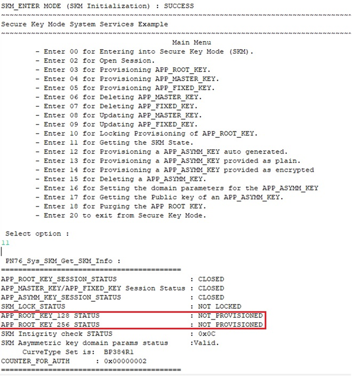

 If you are not sure whether you have provisioned the root key or not, you can check the SKM state by running SKM demo. if the root key is provisioned, please use the provisioned root key.  From below picture, I can see that the app_root_key is  not provisioned, so I use the default transport key.

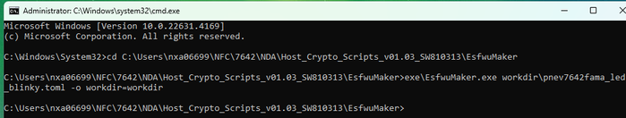

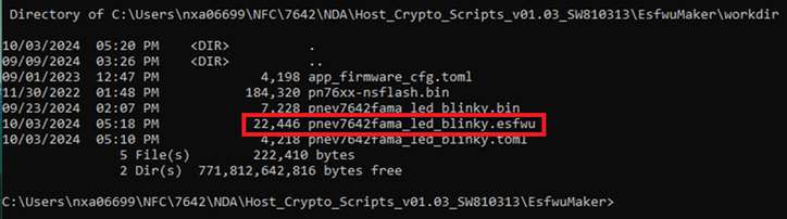

  3.3  use the EsfwuMaker command to generate the Esfwu file.
After this command, we can get the esfwu file.

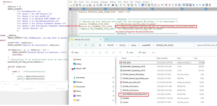

To run the demo, we need to edit the firmware location.  In file DownloadLibEx1.c,  about line 60.

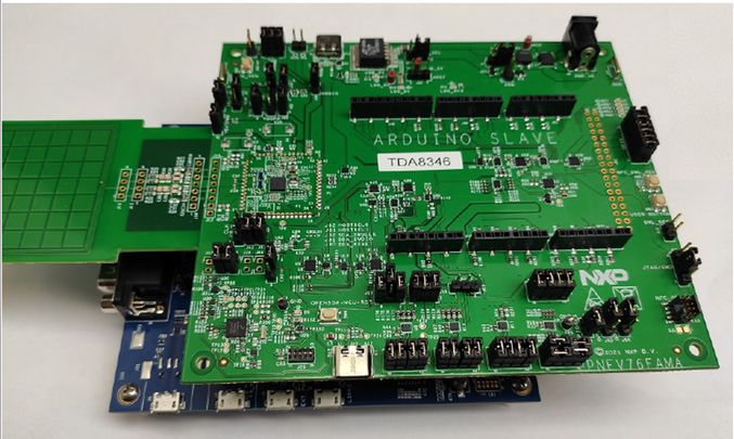

Please set the correct hardware settings as below.  we have to stack the PNEV7642A Rev-B development board on top of the LPC55S16-EVK board.
Align Pin.1 of J36 of the PNEV7642A Rev-B development board with Pin.1 of J9 of the LPC55 board. The last 4 pins, 17 - 20, of J12 of the LPC board are not connected. As well as pin 1-4 of J10 stay unconnected, as below picture shows.

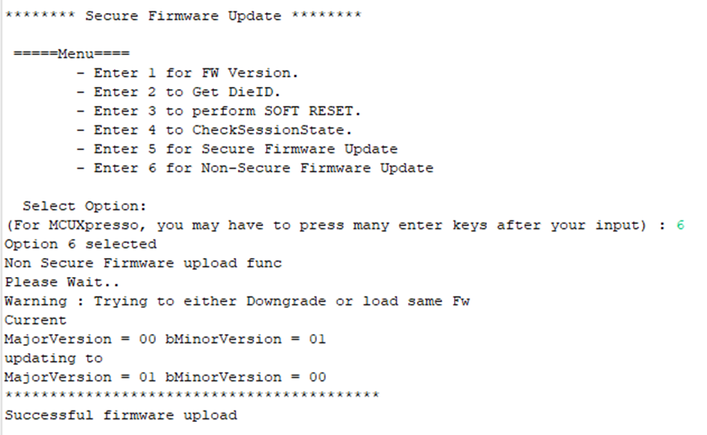

Run the firmware download Demo with LPC55s16,  see the log output below.  Choose option “6” to update your application firmware. The update may take a while.  At the end, a successful update is indicated by the prompt of “Successful firmware upload ”.
To verify it is successful, we can run this demo, please keep J65 open.  you will see the D7 (RED LED) blinky (0.5 HZ rate). If you need the pnev7642fama_led_blinky.esfwu, please let me know.
