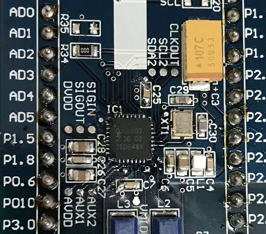

The latest NFC reader library for CLRC663 just supports LPCXpresso1769 and FRDM-K82 boards, so when customers want to porting the library to other host controller, they have to make a custom board at first, or use OM26630FDK and make a little hardware modification by following the steps described in https://www.nxp.com/docs/en/training-reference-material/NFC-READER-K64F.pdf?fsrch=1&sr=3&pageNum=1 to connect the frontend board with host controller board, but today we will discuss an alternative way.

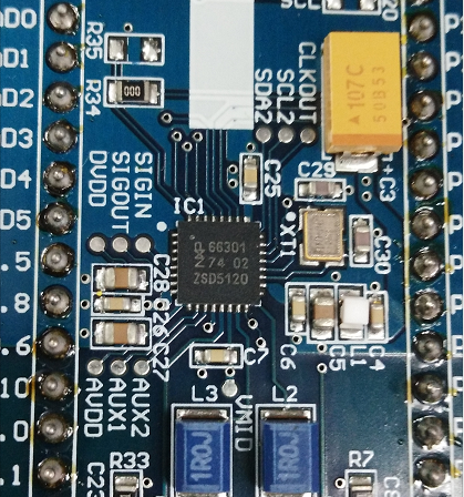

The CLEV663B Blueboard is a pure NFC frontend board, and it supports connecting with LPCXpresso board not limited with LPC1769, the main difference with OM26630FDK is the reader IC, which is CLRC663 not CLRC663 plus, but fortunately they are pin to pin compatible, so we may replace it with CLRC663 plus, and use that board for porting purpose.
Before:
After:
please forgive my poor soldering skill...
