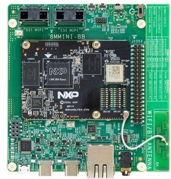

 1  Hardware setup
i.MX 8M Nano Evaluation Kit | NXP Semiconductors
OM27160| Development Kits for PN7160 Plug’n Play NFC Controller | NXP Semiconductors
The connection between i.MX8M Nano and PN7160 OM29110ARD-B
i.MX8M Nano EVK
pin
PN7160
 OM29110ARD-B
3.3V
J1003-1
VDD(3.3v)
J1-4
5V
J1003-2
VBAT (5v)
J1-5
SDA.1
J1003-3
SDA
J2-2
SCL.1
J1003-5
SCL
J2-1
GPIO.25
J1003-37
IRQ
J2-10
GPIO.28
J1003-38
REQ
J4-2
GND
J1003-39
GND
J1-6
GPIO.29
J1003-40
VEN
J4-1

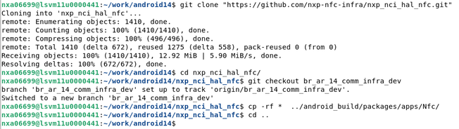

.3.1  nxp_nci_hal_nfc
#git clone "https://github.com/nxp-nfc-infra/nxp_nci_hal_nfc.git"
#cd nxp_nci_hal_nfc
#git checkout br_ar_14_comm_infra_dev
#cp -rf *  ../android_build/packages/apps/Nfc/
#cd ..

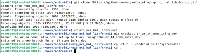

.3.2 nxp_nci_hal_libnfc-nci
#git clone "https://github.com/nxp-nfc-infra/nxp_nci_hal_libnfc-nci.git"
#cd nxp_nci_hal_libnfc-nci
#cp -rf *  ../android_build/system/nfc/
#cd ..

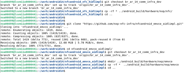

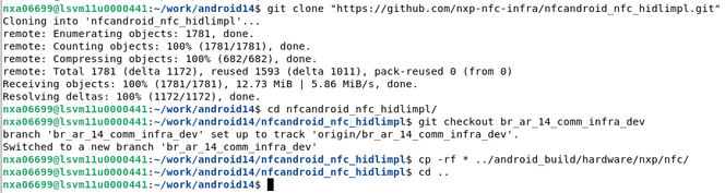

.3.3 nfcandroid_nfc_hidlimpl
#git clone "https://github.com/nxp-nfc-infra/nfcandroid_nfc_hidlimpl.git"
#cd nfcandroid_nfc_hidlimpl
#cp -rf *  ../android_build/hardware/nxp/nfc
#cd ..

.3.5 nfcandroid_emvco_aidlimpl
#git clone "https://github.com/nxp-nfc-infra/nfcandroid_emvco_aidlimpl.git"
#cd nfcandroid_emvco_aidlimpl
#mkdir  ../android_build/hardware/nxp/emvco
#cp -rf *  ../android_build/hardware/nxp/emvco
#cd ..

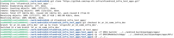

.3.7 nfcandroid_infra_test_apps
# git clone https://github.com/nxp-nfc-infra/nfcandroid_infra_test_apps.git
# cd nfcandroid_infra_test_apps/
# git checkout br_ar_14_comm_infra_dev
# cd test_apps/
# cp -rf SMCU_Switch/  ../../android_build/packages/apps/
# cp -rf EMVCoModeSwitchApp/  ../../android_build/packages/apps/Nfc/
# cd ../..

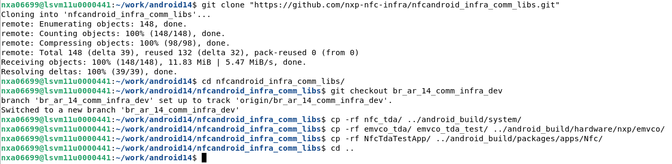

.3.8  nfcandroid_infra_comm_libs
#git clone "https://github.com/nxp-nfc-infra/nfcandroid_infra_comm_libs.git"
#cd nfcandroid_infra_comm_libs
#cp -rf nfc_tda/  ../android_build/system/
#cp -rf emvco_tda/ emvco_tda_test/  ../android_build/hardware/nxp/emvco/
#cp -rf NfcTdaTestApp/  ../android_build/packages/apps/Nfc/
#cd ..

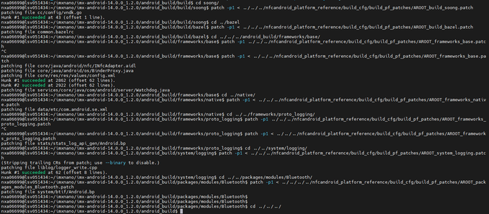

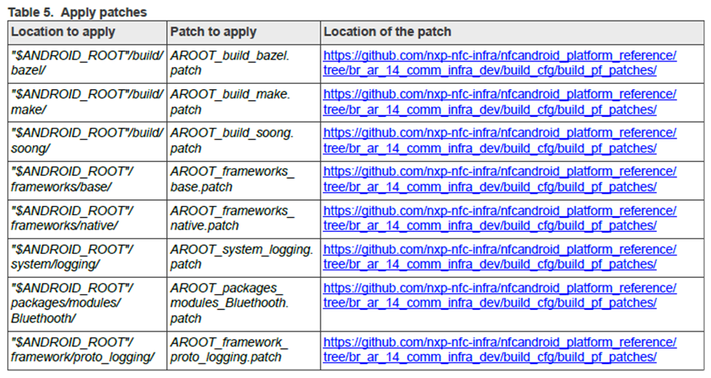

 4   Apply AOSP patches
please see AN14430, page10
# patch -p1 <  ../../../nfcandroid_platform_reference/build_cfg/build_pf_patches/AROOT_build_bazel.patch
#patch -p1 < ../../../nfcandroid_platform_reference/build_cfg/build_pf_patches/AROOT_build_make.patch
# patch -p1 < ../../../nfcandroid_platform_reference/build_cfg/build_pf_patches/AROOT_build_soong.patch
# patch -p1 < ../../../nfcandroid_platform_reference/build_cfg/build_pf_patches/AROOT_frameworks_base.patch
#patch -p1 < ../../../nfcandroid_platform_reference/build_cfg/build_pf_patches/AROOT_frameworks_native.patch
#patch -p1 < ../../../nfcandroid_platform_reference/build_cfg/build_pf_patches/AROOT_frameworks_proto_logging.patch
#patch -p1 < ../../../nfcandroid_platform_reference/build_cfg/build_pf_patches/AROOT_system_logging.patch
#patch -p1 < ../../../../nfcandroid_platform_reference/build_cfg/build_pf_patches/AROOT_packages_modules_Bluetooth.patch

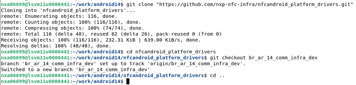

 5    Adding the driver support.
.5.1  get nfcandroid_platform_drivers from github
#git clone "https://github.com/nxp-nfc-infra/nfcandroid_platform_drivers.git"
#cd nfcandroid_platform_drivers
#cd ..

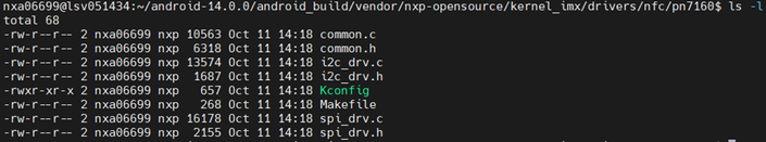

.5.2Create a folder named pn7160 under android_build/vendor/nxp-opensource/kernel_imx/drivers/nfc
Copy below kernel drivers file from “nfcandroid_platform_drivers/drivers/pn7160/nfc/nfc “ into  “android_build/vendor/nxp-opensource/kernel_imx/drivers/nfc/pn7160/”
Common.c  common.h   i2c_drv.c  i2c_drv.h spi_drv.h  spi_drv.c  Makefile  Kconfig
Result of copying:

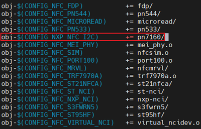

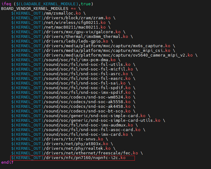

.5.3 Modify makefile
Replace Makefile default code with following code,  only add i2c for simplifying.

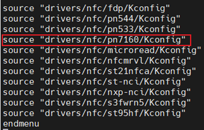

 Now we need to add pn7160 Makefile and Kconfig to main Makefile and Kconfig
Makefile
Kconfig

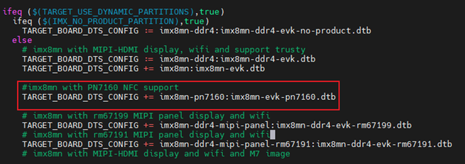

6   Adding device tree
Device tree is important since we need to tell our controller which pins we want to use for communication (this is always different between host controllers)
The device tree need to be added into:
“vendor/nxp-opensource/kernel_imx/arch/arm64/boot/dts/freescale”
Create file with name “imx8mn-evk-pn7160.dts”, open the file and add following lines:
Next task is to add .dts file into Makefile in the following location:
. vendor/nxp-opensource/kernel_imx/arch/arm64/boot/dts/freescale
Open Makefile and add:
Final step is to add NXP_NCI_I2C as module in following file:
. vendor/nxp-opensource/kernel_imx/arch/arm64/configs/imx8mn_gki.fragment
Open imx8mn_gki.fragment and add:

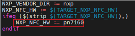

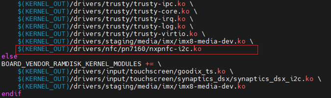

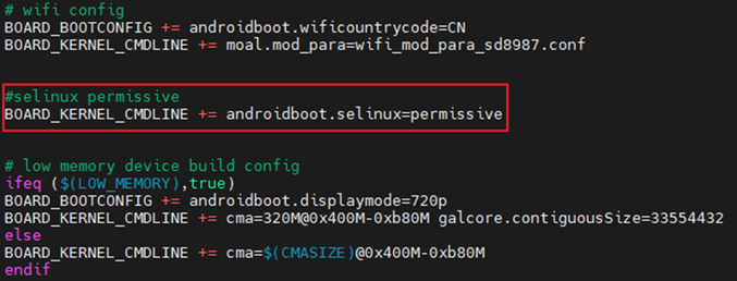

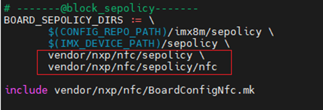

7.1 BoardConfig.mk
7.2 ShareBoardConfig.mk
 7.3 compatibility_matrix.xml
 7.4 device_framework_matrix.xml

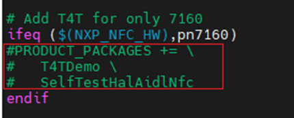

 7.5 evk_8mn.mk

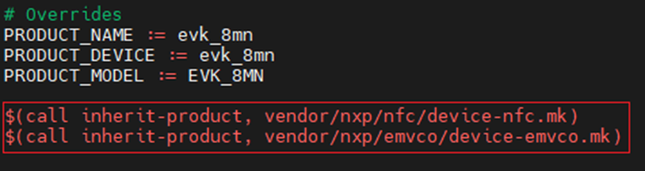

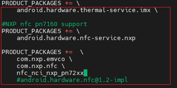

Add .mk files to specific device.mk and some product package directly to device.mk file so everything is build together with Android.

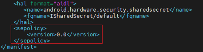

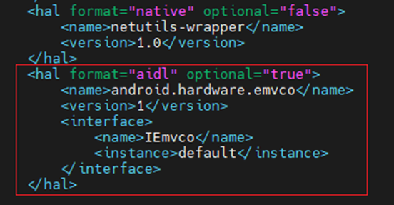

7.7manifest.xml

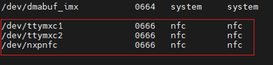

7.8 ueventd.nxp.rc
       Add permissions for drivers

 9    add changes into NXP mk files
. android_build/vendor/nxp/nfc/device-nfc.mk
 .android_build/vendor/nxp/emvco/device-emvco.mk

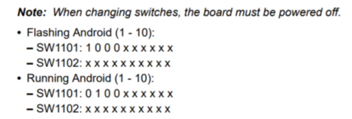

Change switches on i.MX8M Nano
.    Flashing Android: when flashing Android images
.    Running Android:  when images are flashed, put switches to Running Android and Android OS will start.

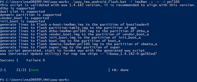

Flash images
.  Put i.MX8 to “Flash Android”
.  Open a PowerShell as admin in the location where download images are
.  Running following command
.  ./uuu_imx_android_flash.bat -f imx8mn -a -d pn7160

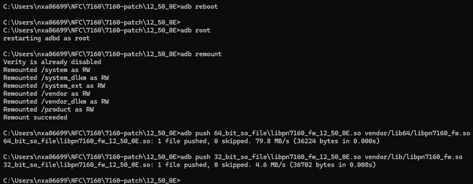

12  Firmware update
Download the FW from Github
Open terminal at the FW location
Run the following commands
  • • adb push libpn7160_fw.so vendor/lib64/libpn7160_fw.so (for 64-bit version) and adb
                 push libpn7160_fw.so vendor/lib/libpn7160_fw.so (for 32-bit version)
  • • adb shell svc nfc disable
  • • adb shell svc nfc enable
