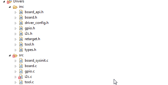

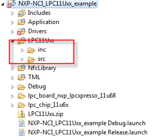

  1. remove *.h and *.c in the folder of LPC11Uxx/inc and LPC11Uxx/src.

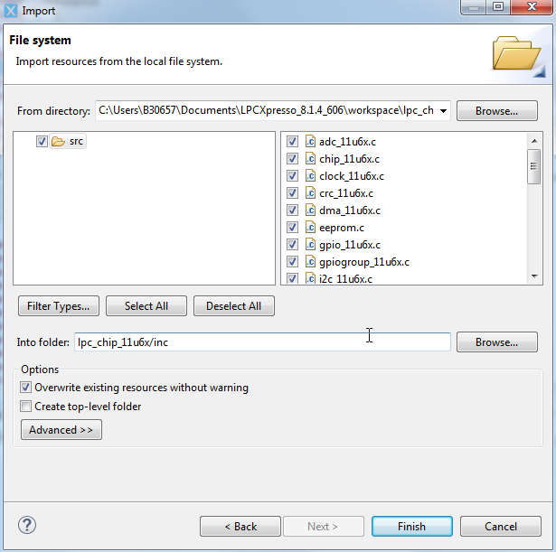

2.import header files and c files from lpc_chip_11u6x/inc and lpc_chip_11u6x/src to LPC11Uxx/inc and LPC11Uxx/src
3. repeat step 2 , import source files and header files from lpc_board_nxp_lpcxpresso_11u68/inc and lpc_board_nxp_lpcxpresso_11u68/src to Drivers/inc and Drivers/src.

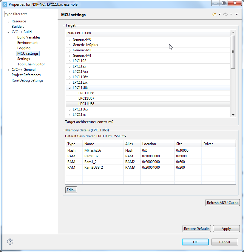

4.Change MCU settings

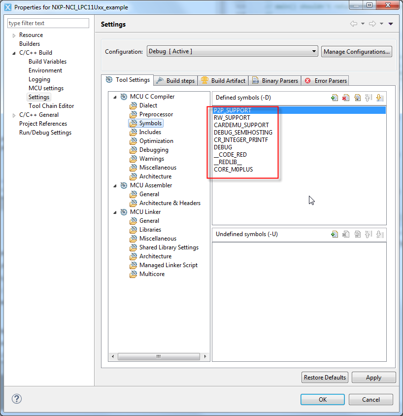

5.Change project settings.

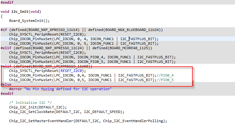

6.compiling error fixes:
6.1
solution: replace with i2c_11u6x.h

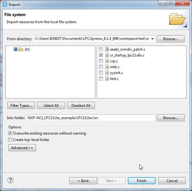

solution: create a template project for LPC11U6x and import the source file of "cr_startup_lpc11u6x.c"

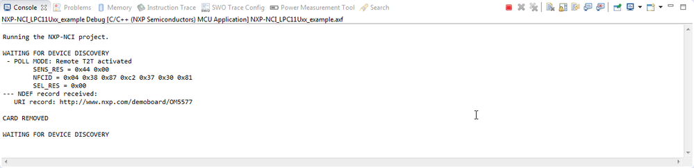

  • Porting Result
This porting guide is for LPC11U68 Xpresso v2 Rev C, and can also be used a reference when you try to port NXP-NCI examples to other lpcxpresso boards.
Please kindly refer to the attachment for details.
