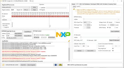

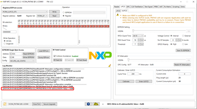

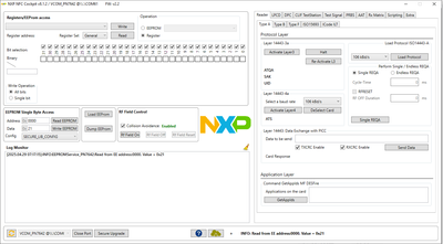

1// Disable DC-DC in EEPROM
OM27642EVK does not required any HW changes for ULPCD (**). User is only required to change the following settings in EEPROM  (disable DC-DC converter).
Address: 0x0000 (Secure_Lib_Config)
Value: 0x21
Reset the board after writing the value.

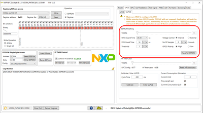

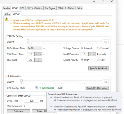

2//Set required ULPCD settings in EEPROM
  • ULPCD VDDPA -> Typically 1.5V. If the HF attenuator is 0x00, increase e.g. to 1.8V.
    • Since the detection range does not significantly depend on the power level, there is no need to set VDDPA above 2 V. Higher VDDPA results in increased current consumption in ULPCD, but does not significantly improve detection performance.
  • RF On Guard time -> This value can be reduced to the minimum -> 5.2 us
  • RSSI Guard time -> Recommended value is 25
  • RSSI Threshold -> Typically 4~6
  • Number of RSSI samples -> Typically -> 0 (4 rounds)

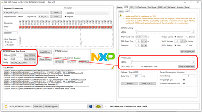

3// Perform "Reads HF Attenuator"
Once the required ULPCD settings is set (Guard times, Threshold....). Then User has to perform "Reads HF Attenuator". Make sure that the "HF Attenuator" option is checked.
As written above, the value must not be 0x00. If so, increase VDDPA.

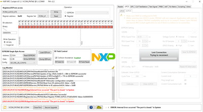

4// Perform ULPCD Calibration and check RSSI Value
For OM27642EVK, the RSSI value for unloaded antenna is typically around 1400dec - 1600dec.
5//Enter ULPCD mode
User can enter the ULPCD mode. The board will again be connected once the load change is detected (e.g. NFC card or smartphone in the antenna proximity).
