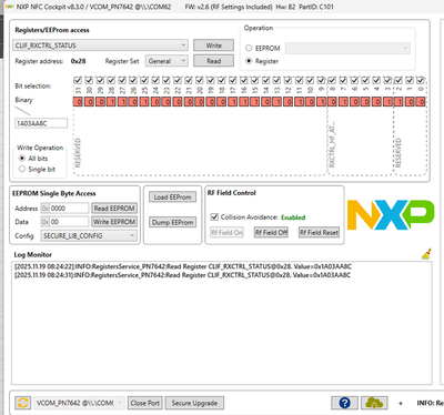

4// HF Attenuator value
  1. Turn on the RF Field with the DPC set and enabled from the previous step
  2. Read the CLIF_RXCTRL_STATUS register and check the HF_ATT_VAL as shown below.
The value for the "unloaded" condition with full power shall be approximately 35-45dec.
If the value is out of this range, the customer is required to adjust the Rx resistors to reach this value.

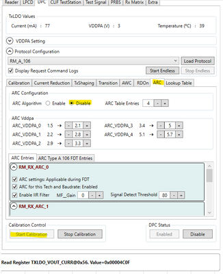

The optimisation of the receiver can be done in the following way:
  • Enter DPC Calibration
  • Go to the "ARC" menu and "disable" the ARC algorithm
This will force the IC to use the RX settings from the following Register/EEPROM
  • SIGPRO_RM_TECH_REG
  • DGRM_RSSI_REG

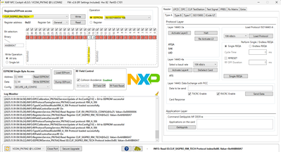

5.1// SIGPRO_RM_TECH_REG (RM_MF_GAIN parameter)
This parameter basically defines the gain of the input amplifier.
  • Select SIGPRO_RM_TECH_REG
  • Switch "operation" to EEPROM and choose the required technology
  • Increase the RM_MF_GAIN to 0x02 (it depends on the setup).

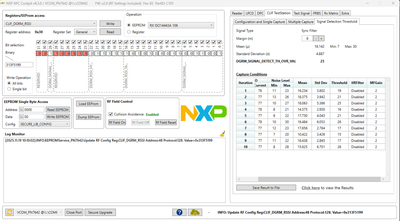

5.2// DGRM_RSSI_REG (DGRM_SIGNAL_DETECT_TH_OVR_VAL parameter)
This parameter defines a threshold from which the internal logic starts to decode the incoming signal.
If the threshold is too low or very close to the noise floor, the system can detect the noise as an NFC Communication.
It is therefore,  Threshold + margin > noise floor
The best routine is to perform "Signal Detection Threshold" analysis. This can be done with the help of the NFC Cockpit (described in PN7642 design-in recommendations)
As a result, the user can obtain the mean value of the "Noise," and suggested "DGRM_SIGNAL_DETECT_TH_OVR_VAL" threshold based on the inserted "Margin."
Maring (m) + Noise mean value (μ) = Threshold
6+16=23
Then this value shall be written in "DGRM_RSSI_REG" EEPROM as shown below.

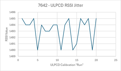

6.1// RSSI Threshold evaluation
For a proper RSSI Threshold selection, it is recommended to perform the ULPCD Calibration, e.g., 20 times, and check the "jitter" of the RSSI signal for your device.
If you see that the RSSI value is jittering, e.g., 1 unit as shown above. The absolute minimum threshold for this case is 2.
However, it is always recommended to include adequate margin (To prevent false wake-ups).
Generally, the margin of 2 units is sufficient. So in this case, the optimum threshold will be 4.
