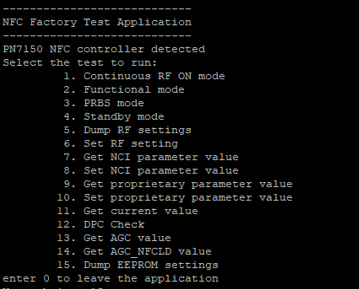

Extended NFC Factory Test Application includes:
  • Get Current value (current measurement in mA)
  • DPC Check (Available from FW. Version 12.50.06)
  • Get AGC Value
  • Get AGC Value NFCLD (AGC value reading with fixed NFC Level Detector level)
  • Dump EEPROM settings
How to get it:
  1. Just download the app from Github.
  2. Replace the "NfcFactoryTestApp.c" with the file which is here in the attachment.
  3. Run the application as described in ->AN13287.

Can you provide the Android version
7160芯片,android 14 ,NFC FW 12.50.09
使用getAGC时返回值不对,请问是什么问题
Hello mark_tang,
For Android, You should just extend the code in the same way as for Linux. Then it should work.
About the AGC value, yes it is strange. You are getting quite a high value, let me double-check the AGC range.
Thanks !
Tomas
