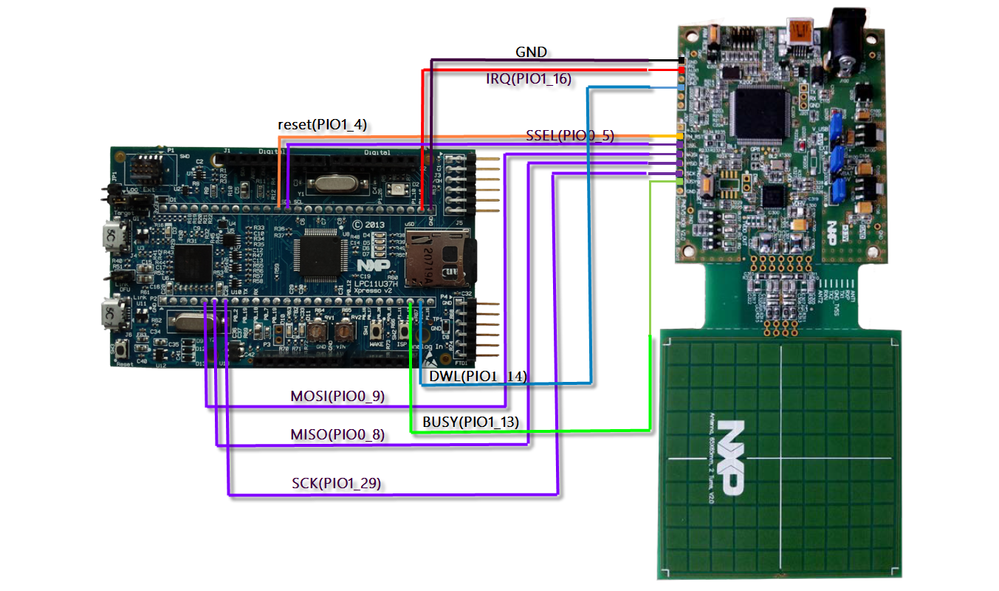

  • Hardware Setup for porting:
a) Remove resistors on PNEV5180B to disconnect the onboard lpc1769 from PN5180, following steps on page 16 of https://www.nxp.com/docs/en/application-note/AN11908.pdf
b) Connect LPCXpresso board for LPC11U37 with PNEV5180 as below:

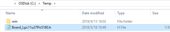

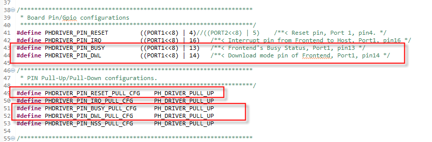

1. Make a copy of Board_Lpc11u37Rc663.h , and change its name to "Board_Lpc11u37Pn5180.h", and import it into the DAL/boards folder.
2.Change the source code in the header file as below:

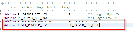

3. Add two more pins' definition and configuration for BUSY and DWL pins of PN5180, and new configuration for reset pin.
and modify the reset logic:
4.Change the IRQ interrupt trigger type to rising edge.

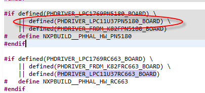

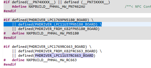

5.Include this header file in BoardSelection.h
6.Add this new configuration in ph_NxpBuild_App.h
7.Add this new configuration in phApp_Init.h
8.Add this new configuration in ph_NxpBuild_Platform.h

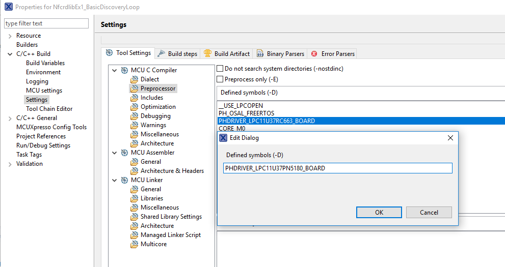

9.Add this new configuration in Settings.

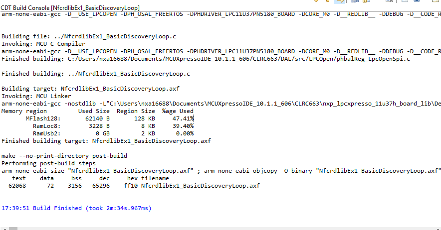

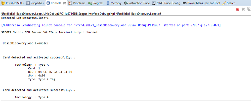

10.Building result:
  • Testing result:
