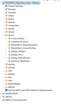

Add the source code Discovery Loop Example
From the imported example NfcrdlibEx1_DiscoveryLoop_mcux of the NFC Reader Library, find and copy the following files (included in src folder): NfcrdlibEx1_EmvcoProfile.c, phApp_Helper.c, phApp_Init.c, phApp_PN5190_Init.c; and paste them into the source folder inside the created base project. Additionally, delete the file hello_world .c created by the project.
Habib_MS_0-1781134009079.pngHabib_MS_0-1781134009079.png            Habib_MS_1-1781134021054.pngHabib_MS_1-1781134021054.png
Additionally, we need to add the file “NfcrdlibEx1_DiscoveryLoop.c” which is the main source file of the project, to do this right-click on the “source” folder of our project and then put the cursor on “New” and select “File”.
In the tab that will open, write the name of the file (NfcrdlibEx1_DiscoveryLoop.c) and then, click on “Finish”.
Finally, in the created file copy and paste all the code inside the original source file located in the library example.
