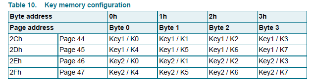

Then according to  section 7.5.7 of the datasheet the sections  where the 3DES key are saved are the 2C (Page 44) to the 2F (Page 47).
We proceed to  write our new key using the A2 (WRITE command)
Command
Data message
DATA = byte 07,06,05,04
11223344
WRITE to page 44 (2C)
A22C11223344
Positive acknowledge (ACK)
0A
DATA = byte 03,02,01,00
55667788
WRITE to page 45 (2D)
A22D55667788
0A
DATA = byte 0F,0E,0D,0C
99112233
WRITE to page 46 (2E)
A22E99112233
0A
DATA = byte 0B,0A,09,08
44556677
WRITE to page 47 (2F)
A22F44556677
0A

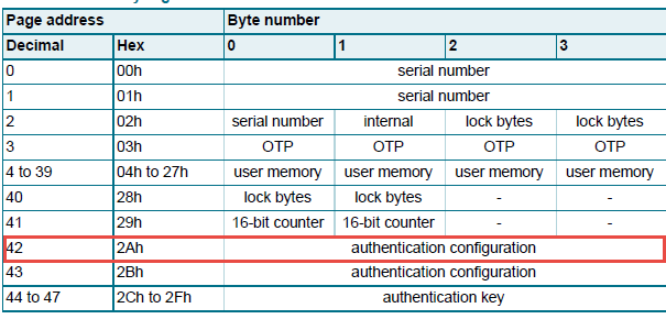

we proceed to define from which sector the authentication is needed in order to read or write, to do this we use a write command to the AUTH0 (AUTH0 defines the page address from which the authentication is required. Valid address values for byte AUTH0 are from 03h to 30h.)
the AUTH0 is located on the section 2A please check table 5 from #datasheet.
**for this example we will define that from page 6 (06) we will need authentication to perform a read or write operation**
Command
Data message
WRITE command (A2) to AUTH0 (2A) from page 6 (06)
A22A06000000
0A
Now the Read capabilities from page 06  require an Authentication in order to be read or written.
