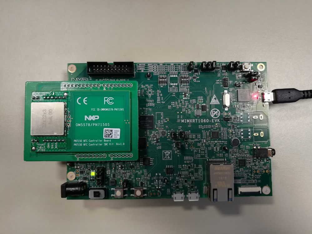

Hardware Connections
The hardware connections are simple. Both the EVKB-IMXRT1060 board and OM5578/PN7150ARD board have an Arduino interface. So, mount the PN7150ARD board with male Arduino connector onto the female Arduino connector of the EVKB-IMXRT1060 board.

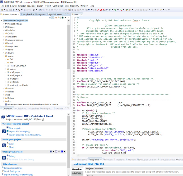

  3. Drag and drop the downloaded package to the “Project Explorer” tab of your MCUXpresso IDE workspace (If you don’t have MCUXpresso, it can be downloaded for free from here:
    https://www.nxp.com/support/developer-resources/software-development-tools/mcuxpresso-software-and-t...

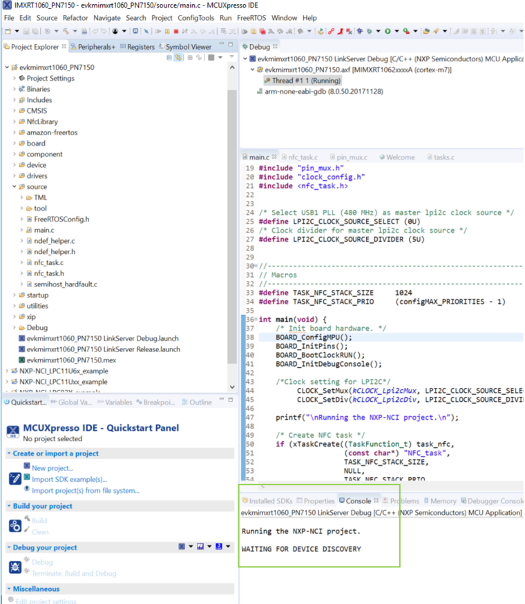

  4. Now that the package has been imported to the MCUXpresso IDE (via drag and drop), click on Debug icon from the Quickstart panel to begin a debug session. Once the debug session has started, click on the run icon to run the code:

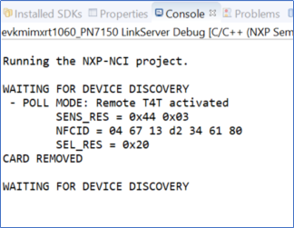

  5. After step 3, the project should be running now. The project contains basic discovery loop functionality. Here is how the output looks in the console tab on MCUXpresso:
    Bring any NFC card near the PN7150 board’s antenna and the output console will show the detection and type of the card. For example, in the picture below, we can see that type 4 card was detected: pastedImage_63.png
