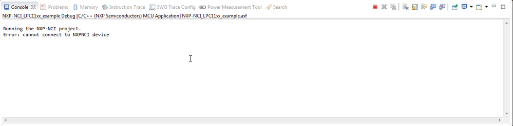

The latest NXP-NCI example is rev 1.6, and when you run this demo with the lpc11xx board, for example, lpc1115 rev A, and the OM5577, you may meet the following issue:
The problem is due to two aspects: one is hardware and the other is software.

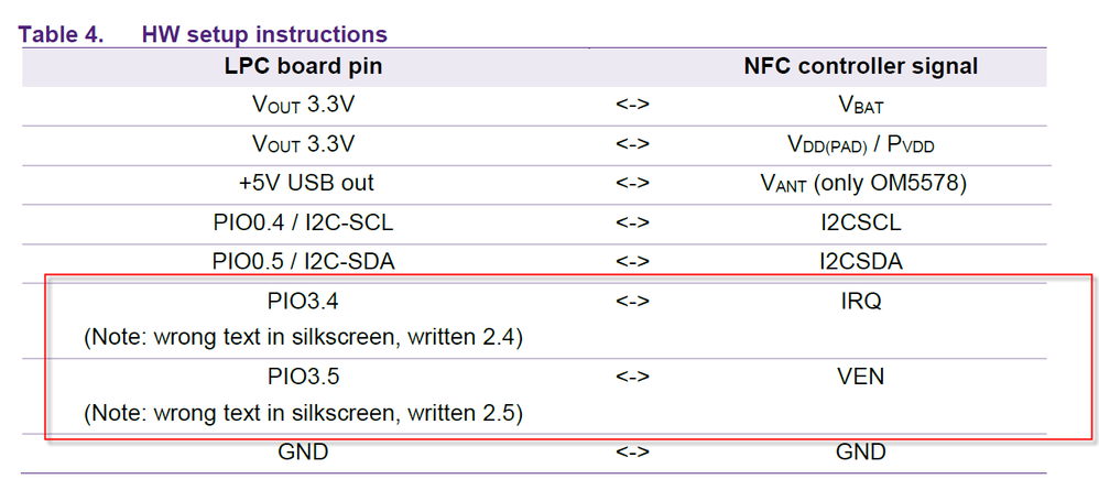

  1. For hardware solution, besides following what is described in AN11658 section 2.4 LPC11xx, you have to do one more thing:

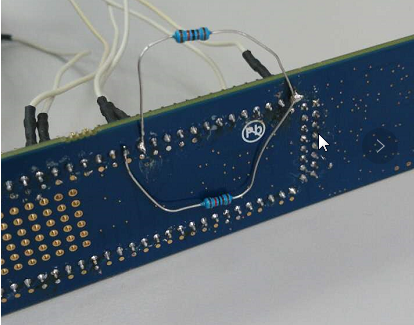

    a) The I2C lines are not pulled-up: LPC11xx doesn't offer internal pull-up setting of the I2C lines so external pull-up resistors must be added.187042_187042.pngpastedImage_4.png

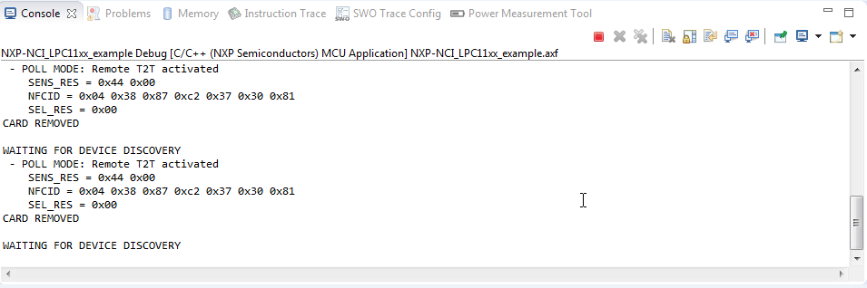

  3. The result is shown as below:187043_187043.pngpastedImage_5.png
