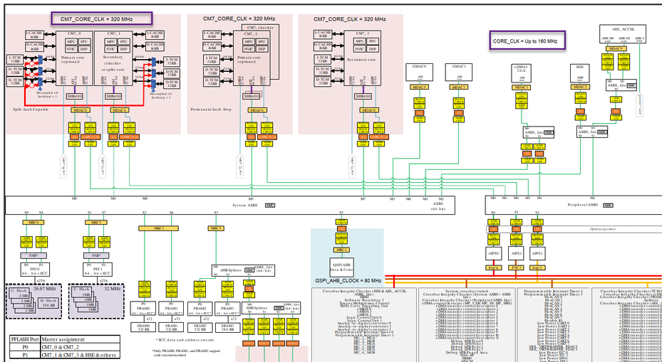

FOR S32K388, how to achieve maximum operational frequency of 320 Mhz?
FOR S32K388,
Configured CM7_CORE_CLK = 320 MHz and Core_CLK is 160 Mhz.
What are these clocks and which clock frequency is used for Core?,  (CM7_CORE_CLOCK or Core_Clock)
Where is the other frequency is used?
if we measure the cycle time with this configuration what is the frequency we will get?
What are the settings required for maximum operational frequency of 320 MHz?
Re: FOR S32K388, how to achieve maximum operational frequency of 320 Mhz?
Hello @Sambasiva,
Refer to Figure 11. Block diagram – S32K389 in S32K3xx RM, Rev. 12, 2025-11-11.
CORE_CLK is the system clock.
While CM7_CORE_CLK is the clock of the CM7 cores.
All the clocks must be configured precisely according to Table 153. Option A++ - Very High Performance mode (CM7_CORE_CLK @ 320 MHz) (For S32K388/S32K389).
