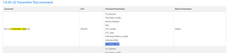

How do we change BLE TX Power for PHY1 and PHY2 in the Test Tool when using the FRDM-RW612 eval-kit?
It seams that the tool do not support the set TX power in the HCI cmd HCI_LE_Transmitter_Test [v4]
https://www.bluetooth.com/wp-content/uploads/Files/Specification/HTML/Core-54/out/en/host-controller...
NXP Test Tool 12 (BLE HCI 5.0 16.1.xml)
This looks more like "HCI_LE_Transmitter_Test [HCI_LE_Transmitter_Test [v2]]"

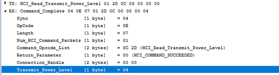

When reading the TX power using HCI_Read_Trasmit_Power_Level:
Type[0] = 0x4
Type[1] = 0xC
Tusisima_2-1786712798212.pngTusisima_2-1786712798212.pngTusisima_2-1786712798212.pngTusisima_3-1786712807179.pngTusisima_3-1786712807179.pngTusisima_3-1786712807179.png
Re: RW612 - Changing TX power - FRDM-RW612 - Test Tool
The tool wasn't updated.
To work around this, you can set the TX power manually by sending raw HCI packets directly.
Daniel.
Hi Daniel,
Can you give an example of a HCI cmd that can change the power and is supported by the Nxp HCI API?
